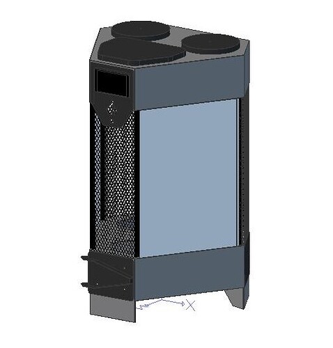

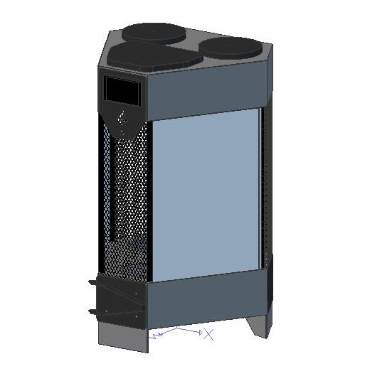

So fresh of the Drafting board is the all new Fusion Gasifier module. There will be a light version and a Standard version. The standard will share the same automation package as the power gen modules.
This thing is going to be awesome!!

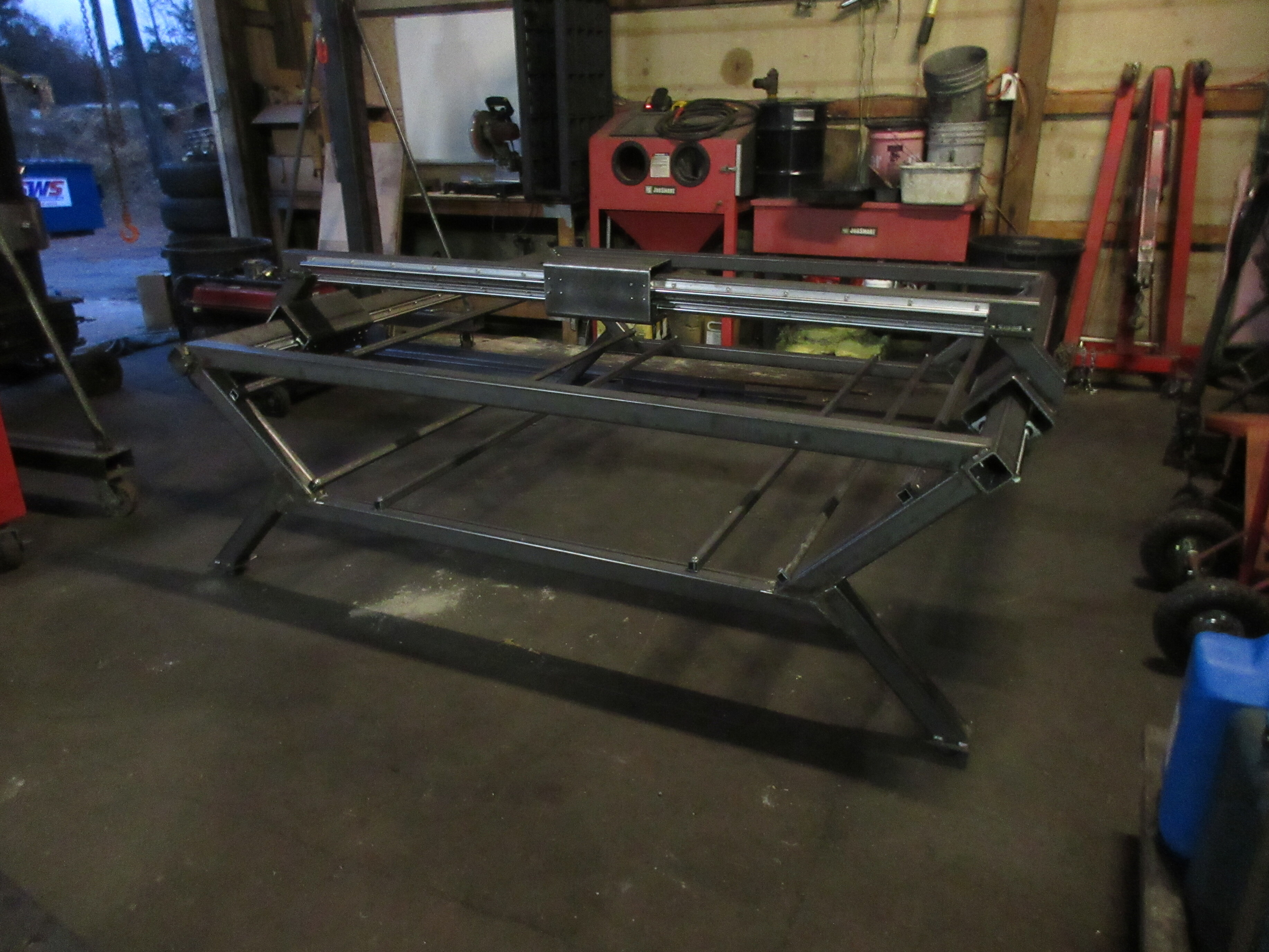

So the CNC machine is taking shape, it is ready for paint and then I can move on to installing the motor drives, electrical and the Z axis slide.
The tri pillar “Fusion Gasifier Module” I posted earlier is going to be part of my development plan. My plan is to make revision that will allow this unit to have a second on board combustion stage. I will also have a revision for a lower charcoal unit and steam reformer system built into it.
So basically it could then be installed just like a pellet stove and run in full combustion mode. But it will have a way to shut that internal second stage down and divert that gas outside to an outdoor power unit. More evolved controls will detect room temperature along with keeping an eye on battery storage charge levels. The controls can then manage mode based on these inputs. If room temps are at high temp parameters it can shuttle to power generator mode and then switch back when the room gets cold. The Charge state will always trump the room temp parameter and if the batteries are at low voltage cut off it will switch and run a full charge cycle. But even in a power gen mode the machine is still going to offer heat.
With this system the gasifier is always running and up to temp. When power is needed, starting the engine will be nearly instant.
The tricky part here, is how do i enter air for that second stage combustion with out blowing the thing up?? So yeah its going to look like an episode of mythbusters when I start testing this thing. Ill have a long cable to remotely shuttle open an air intake valve and igniter system.
Cue Adam Savage: “Stand back – we’re going to try science!”
