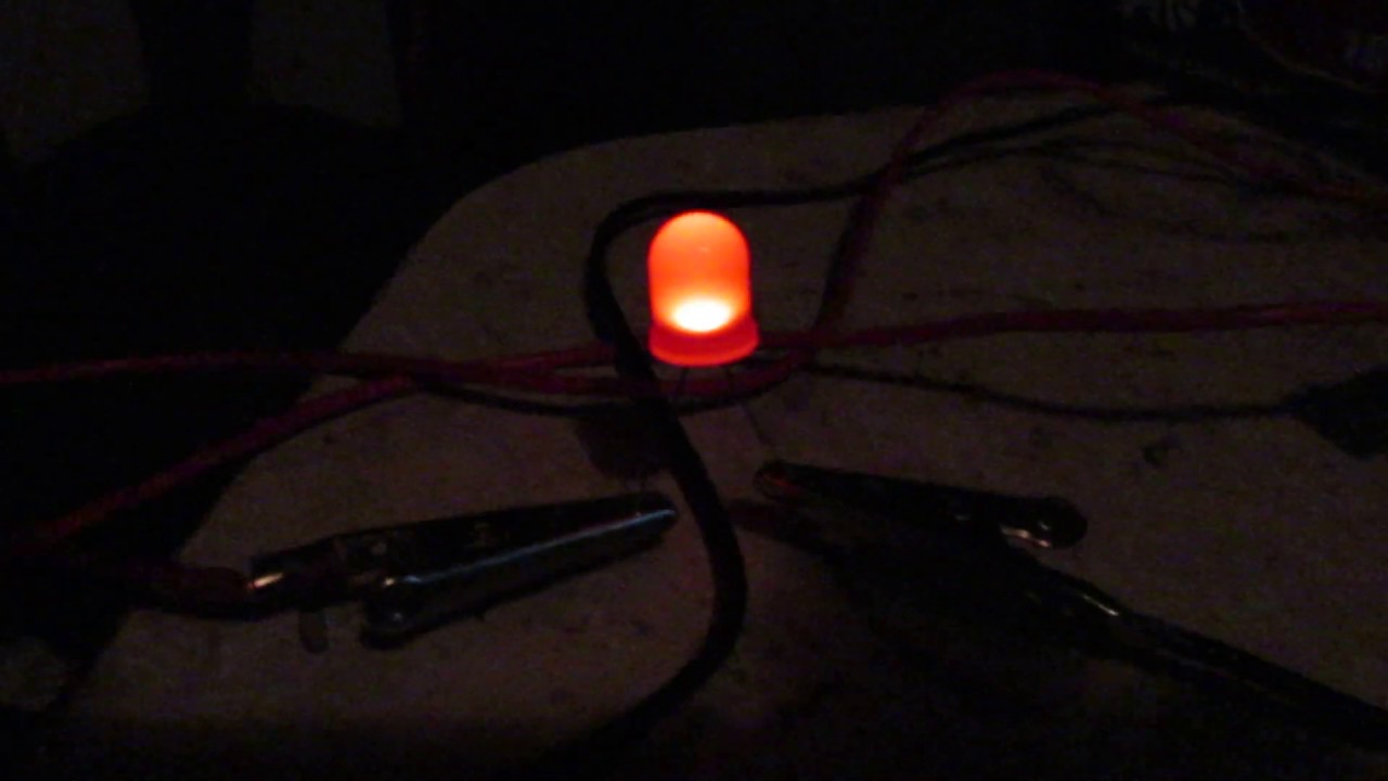

If you guys remember I was tinkering with a printable TEG / Heat battery over the summer. I did contact Robert Murrey Smith to ask for some help. Well here is doing something similar. Not saying he is stealing my idea, I be happy if he did take it on and at least experiment. But here here he is not but it is somewhat similar. I left in the comments exactly how I did and my results so hopefully he at least does a small experiment to see what Im talking about
It did pretty well for the small temperature difference especially with it being about room temp.
Yeah here in this video I am producing 2 volts with a single cell. Note after I take the heat away the LED continues to brighten.
so you are saying that once started your unit will work as a battery and keep working without heat
