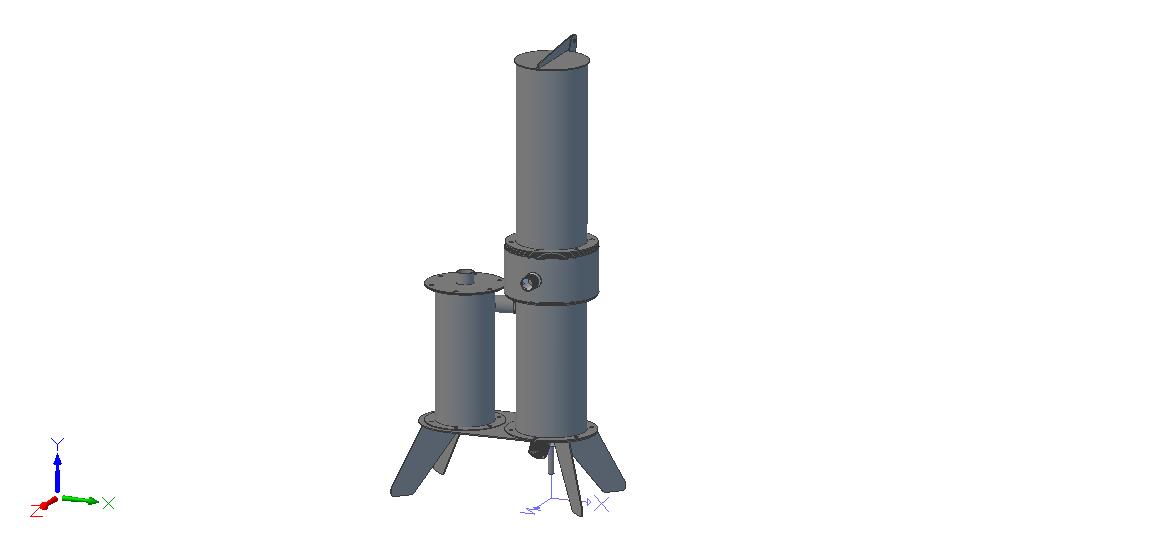

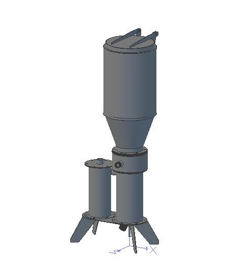

Designed an expansion hopper option for this little guy. This will have to come at a bit higher cost as this is a bit to do. This should give the machine 4 to 5 times the run time verses the standard hopper.

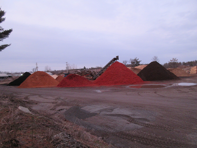

Well if I survive the Apocalypse, Ill have plenty of wood chips for power and heat. This is the business behind me. Its ironic they started their business in the unit I took over.
And Matt, I was worried that you werenât enough of a salesman to keep the business going. LOL. Good Job. on everything, as usual

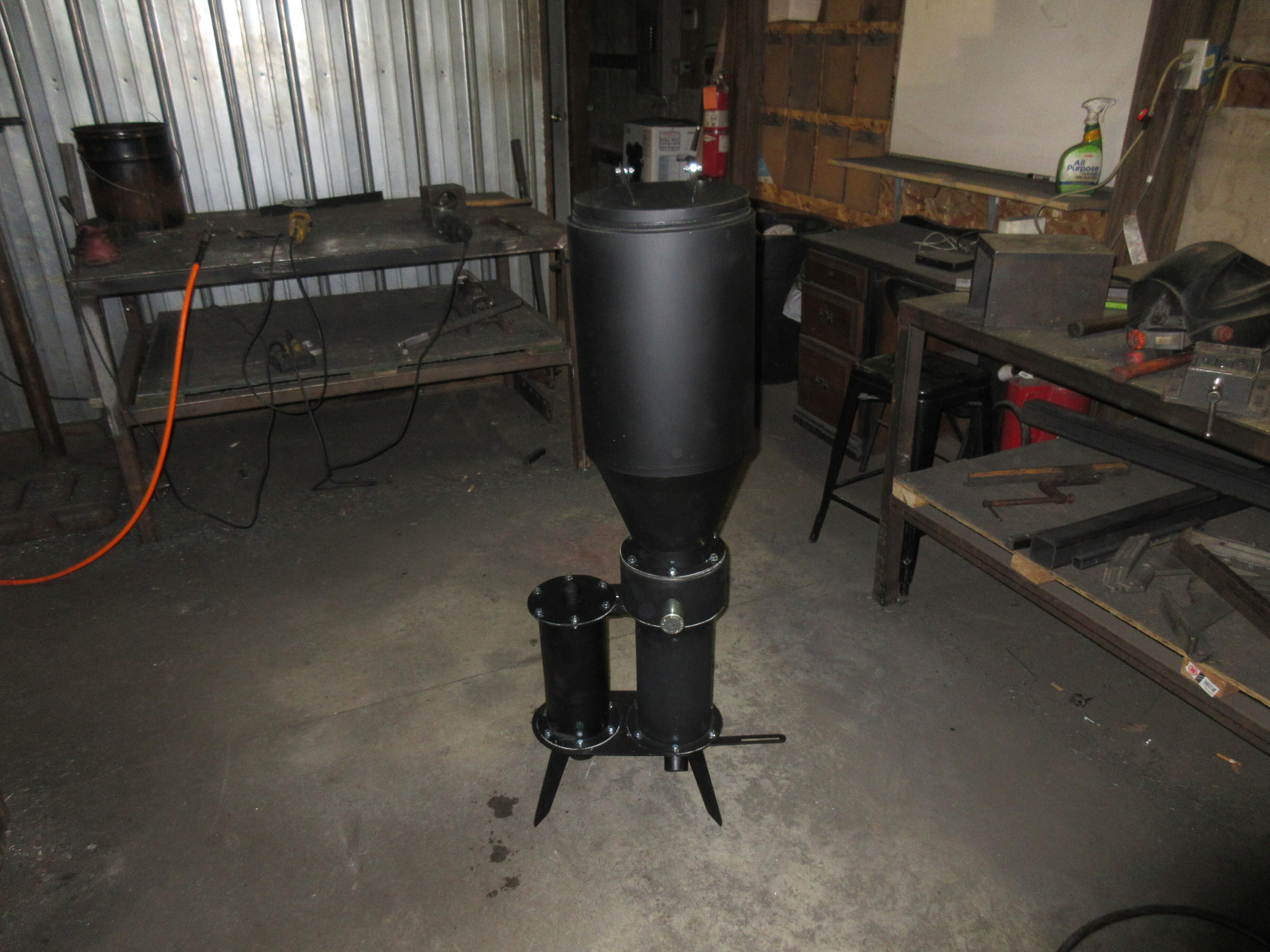

So cranked this guy out. This has the expanded hopper option. I need to make a flange set to couple the cyclone intake port to the reactor exhaust port yet. I had planned on using a simple hose coupling but the hose I have is too small. So low on budget I must compromise lol.
Next is to build the barrel drum bag filter and figure out how to connect it and I should be up and running in no time.

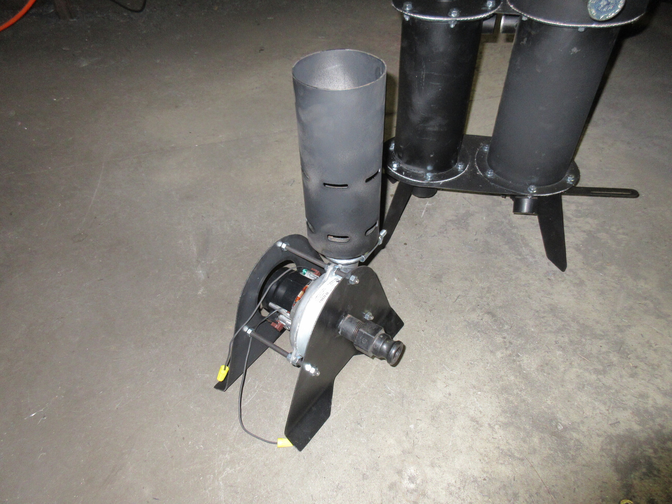

Also I built the AmTeck start up blower module. I plan to sell kits for this blower.

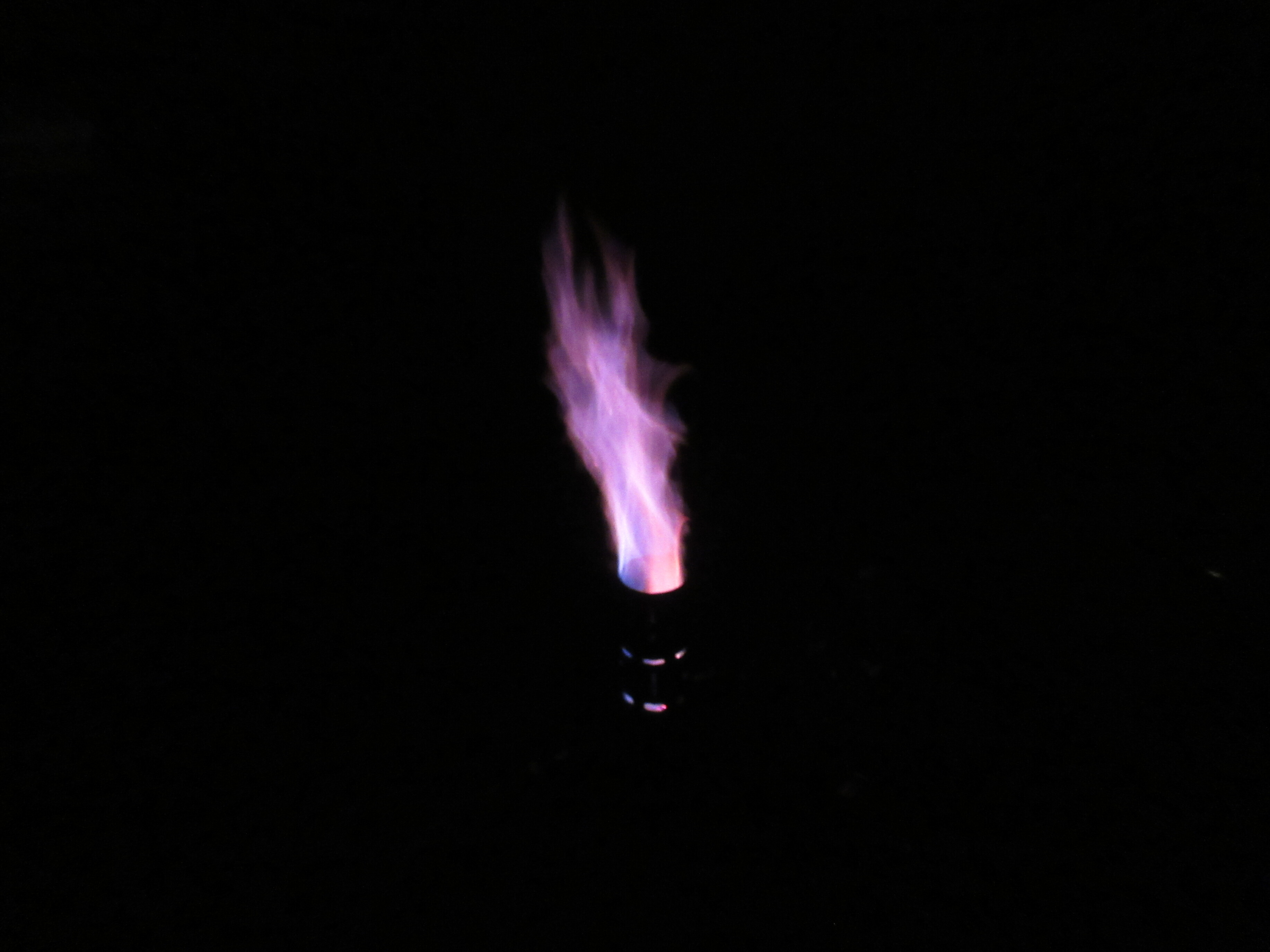

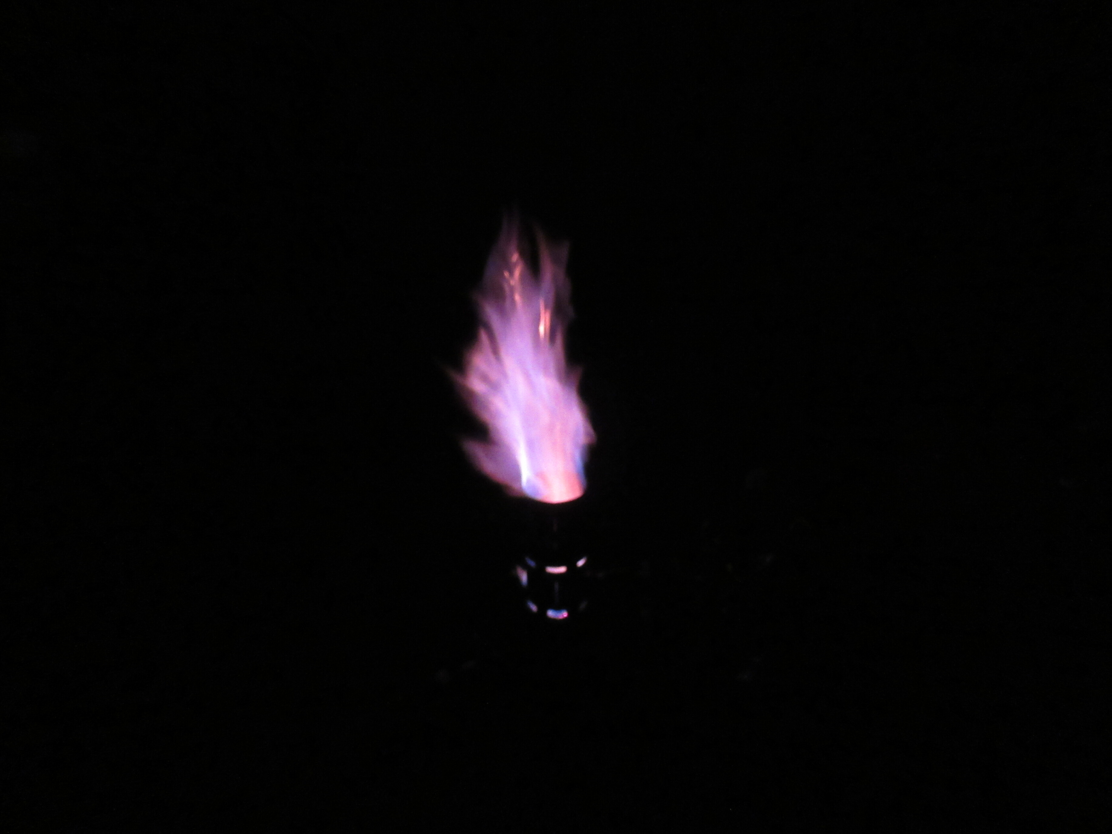

First run on the new Flex Gasifier. I think its running a bit rich. Im going to add another ring to lean it out some. The barrel filter has been converted into a bag filter with a dual lined bag. It has the ceramic cloth on the interior side and then a felt layer and the outer.

I think Im learning something new. This blower is so powerful, that I think it is acting like a turbo compressor. This sudden switch from negative pressure to positive pressure I think it condensing the tars out. The flare actually looks great but there tar streakers flying out. So Ill just throw another filter at it, I think I need a good cooling stage and a two stage bag filter and it will be good to go. Right now it spitting moisture at the carb adapter with some tar in it. Not too bad a splash of gas will take care of that, but Ill have to add another filter to get that remaining moisture out.
Oh and yeah this is the blower with a throttle installed. It is only slightly open and running on a speed control at its lowest setting. I can open that up and crank that blower up all the way and shoot out a 4 foot flare out of that thingâŚ
