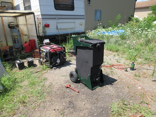

Put a full hopper load of fuel in this thing to see how long it will run for. It has a pretty fast water drip and is running stable. It had a hard time getting going, might be the left over fuel from last night. In the future Ill smash it down before reloading.

Engine would not come up to rpm, took about 5 minutes before it took off.
I think my jet needs to be a few inches longer. Its not burning down evenly or is this what we want?

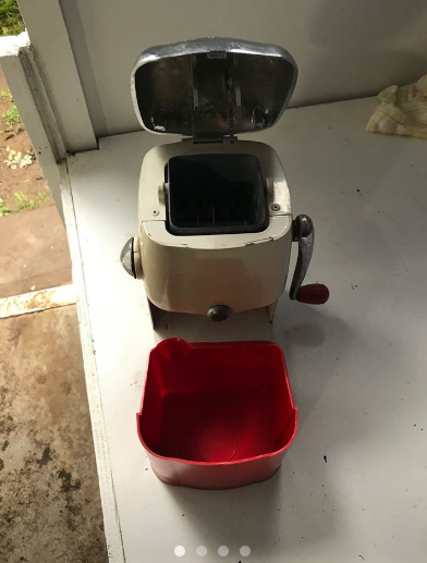

Just found this item for sale on market place its a ice crusher so tempted to buy it for the $50 he wants just to see if it would crush charcoal

Ok yeah I can only get about 2/3 of the hopper that will run stable. So that make sense.
Yeah the water drip is impressive, when I get it good and hot I can dump quite a bit of water into that thing. I think a more refined with steam flashing and automation controls could really improve this.

Hi Matt , is this still a cross draft ? or have you converted it into a updraft ? can you do a sketch or explain how you have the inlet and outlet positioned and the distance between the 2 if it is still a cross draft .

The hopper at the nozzle level extends 11" back. There is a gas pick up tube welded to the back. However this does not extend all the way to the jet level. Originally it was 6 inches higher. It is now about 10" higher giving the gas a larger area to penetrate through.
The gas pick up tube extends up to the top and transfer the gas to back bag filter chamber.
