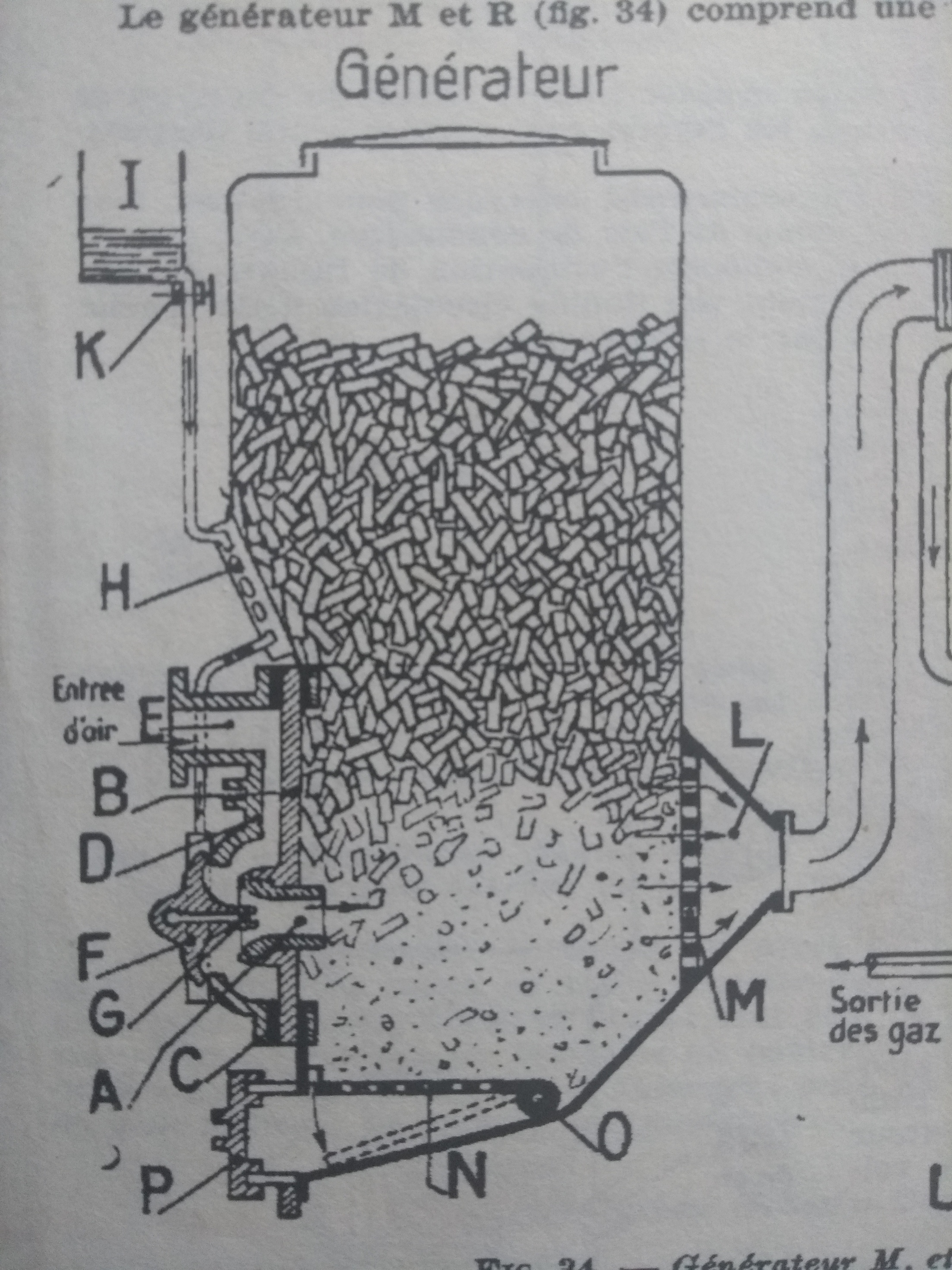

I would like to pressurize the steam to produce a venturi effect on the air entering the nozzle (to compensate, a little, for the pressure drop of the gasifier)
here is my source of inspiration. We can see in this drawing a nozzle for the water vapor in the axis of the air nozzle
if the steam jet enters the nozzle at high speed, the air is sucked in by the venturi effect
this configuration pressurizes, slightly, the air in the generator and reduces the pressure differential between the inlet and the outlet of the gasifier . What do you think ? :thinking:
