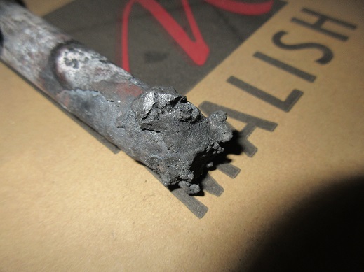

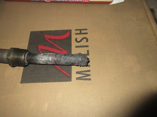

Well I did not get before pics, but it does look like it melted :frowning:
May just need to shorten it is all though. It does stick far into the reaction zone. I think if I shorten it and get it closer to the end of the jet that may help some.
Hi Mat , its a long road testing for the right material for nozzles but if you can design a way to be able to use mild steel pipe nipples then you are way head of anyone else .
How much water did you have running into your blanked off tube ? maybe more would help if not then its back to the drawing board , unless you go down the road of the tungsten carbide nozzles that a few of us are using .
Anyway i’m really happy to see your little baby up and running and i am sure it wont be long before you have it all sorted and running like a good un .
I think its just too far in there. I shortened it and going try again. If it melts Ill shorten it more. I think in the end of this the outer nozzle may end up being just slightly longer. It will shroud this pipe.
But on the original set ups I have zero issue with nozzle melting. Just shroud your nozzles with a heavy couplings and you should have the same results. But what Im after is more efficient water cracking along with more stability. That this new set up is doing quite well and doing so on a crude build.
Ok one thing I did find is the water drip did not extend all the way back. That may have the issue. The melting does not extend where this terminated. I found after I shortened the evap tube and then resized the drip tube. I cut off an inch of the evap tube and only a half inch of the drip feed tube. I think it is all a matter of tuning, I think Ill get this working!!

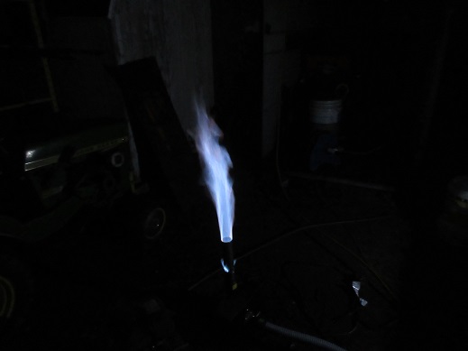

Quick video of it at night with the water drip.
IMG_2104
Ok one thing that has changed is the fuel consumed all the way to the jet!! That is also something else I was hoping to achieve. the machines I build do not do this. There is generally 8 inches of fuel left above the nozzle before they die out for some reason.
What do you think makes it use more fuel before it dies compared to your other builds?
The jet configuration is different. The normal set up is just a typical jet sticking in there. I think the air deflects in all directions. Where this the air is feed through this outer jet but from the sides of the inner evap tube. So the air stream is more concentrated to the sides verse all the way around.

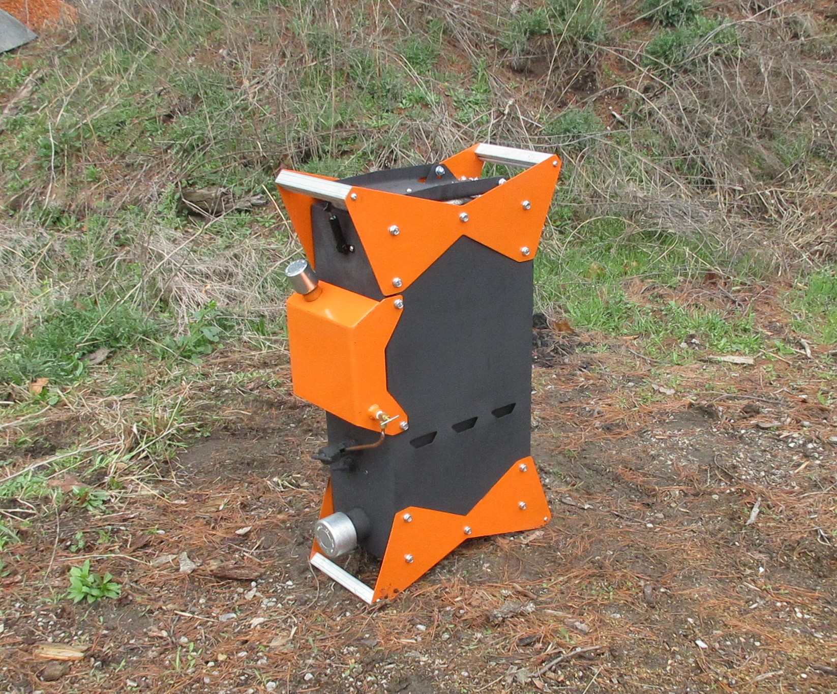

I got to thinking about what Mark said about the availability of those large ammo cans and he’s right. I’m not sure where I could find one that size. You can get .50 caliber boxes at Surplus Center.
https://www.surpluscenter.com/Miscellaneous/Ammo-Boxes-Cases/50-Cal-Ammo-Box-End-Hinge-1-1099-A.axd
but they are just about the same size as the Harbor Freight ones I use. One solution may be to get two cans and cut the bottoms out of them leaving enough flange to seal and bolt them together. Then you would have a container that opened at the top for filling and also at the bottom for cleaning. Anyway I really like this design. Easy to adapt and experiment with.

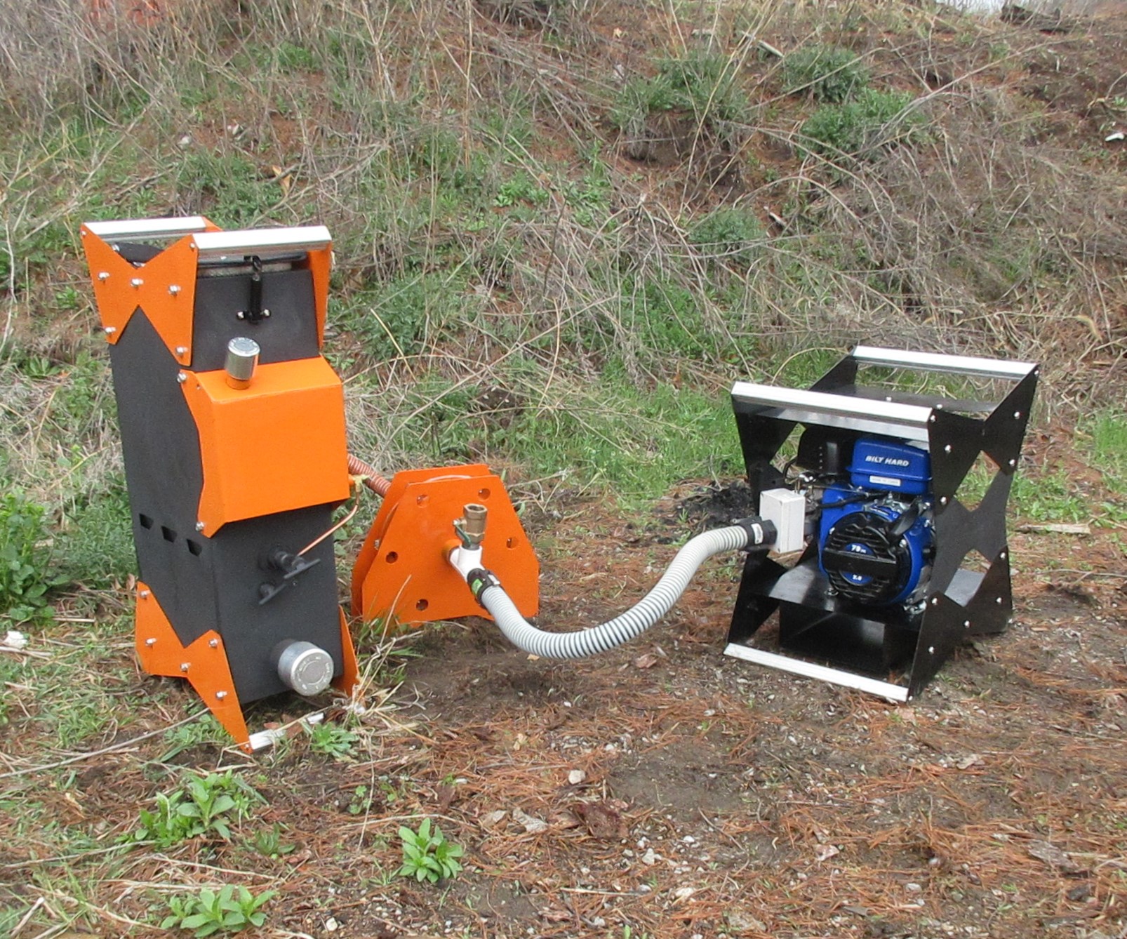

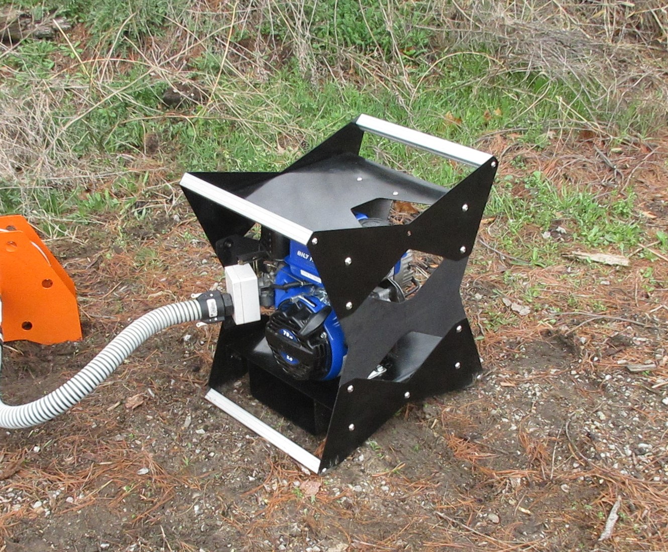

Well looking at the Predator 2000 watt inverter genny, it is a bit out of budget. So ordered a 3 horse engine, small self exciting alternator, shaft couple and foot mounts to build my own.
Those little 79cc engines are great. Harbor Freight sells those too sometimes with coupons.
Yup, I would have rathered getting the HF Predator, but this one is cheaper delivered. So Im running with it. Yeah I had one but it grew legs and ran off!!
Yeah I went ahead and ordered this inverter as well. Total cost now is, $425.74 :frowning:
So the Predator 2000 watt inverter Genny is $550 buck plus tax. So total savings? $157.26
Not sure about my decision on this one. But I did it my self!!! lol
