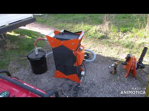

Looking clean and sharp as always with your builds!
I think it looks sharp as well.
The bowtie’s are a spiffy addition. :stuck_out_tongue:
looks smart enough to take out with you anywhere . well done that man !
Matt,
What filter material is in your “pancake” filter and what is the procedure for accessing and cleaning it?
Matt, your constructions are really beautiful. on the last photo why the secondary air control valve is on the filter and not on the mixer? Isn’t this to overburden the admission less?
I never hang a mixer valve on an engine. That extra weight can stress harden the bolts that mount the carb to the head and they can break off. Its a real PITA to get them out as most the time they use lock tight when installed. Plus the engine vibration makes it dificult to fine tune.
I always mix remote from the engine especially the electronic versions.
I use two different materials. For higher temps I use silica cloth and the for the colder fine filter I simply use filter felt its what it is made for.
Here is my tutorial on how to DIY a bag filter using filter felt or silica cloth. This filter is very effective while still being passive to reduce restriction of gas flows.
Where did you source those lid clamps and the ceramic fabric, please. I need some.
If you are building a filter do not use those rings, you need to spring load that lid so it can relieve pressure. But anyways they come with the lids. https://www.amazon.com/dp/B0052P1QM4?psc=1&ref=ppx_yo2_dt_b_product_details
Just do a search for silica cloth, I get it from McMaster Carr. https://www.mcmaster.com/silica-cloth/flexible-silica-fabric-sheets-and-strips/
I was asking about those four spring hold downs you put on the lid. I always figured that in a blow back that the flex hose would just blow off.
Ah ok sorry I miss understood. https://www.mcmaster.com/1344A27/
What thickness do you use @Matt ?
Do you get the intake manifold completely clean with your filter?
The filter felt I use the 1/8 inch thick felt. For the most part yes the gas is fully scrubbed other some fine soots that leave a very slight residue. Other than that all the dust is removed, the dust cant get past 100 micron filter.
