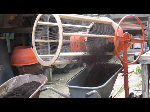

Im going to build a tumbler dryer much like this. The plan is the use a 55 Gal drum with removable lid. Then cut the mid section out and put expandemetal in its place. The on the lid end there will be a set of rollers ( prabably the same wheels we use on the gasifiers) to cradle that end. Then the closed side there will be spindle / shaft set up with a belt drive from windshield wiper motor. This be set on a timer
You then fill it, put the lid and turn it on. The motor will advance 90* or so every fifteen minutes or what you set the times at and just let it run until the fuel is dry. But this will also get the fines and dirt out.
I think I found where clinkers come from. The batch of charcoal I fed chips into the process and those chips were full of dirt. Ran that in the gasifier last night and she clogged right up and gas exhaust was extremely hot. So Im suspecting its full of clinkers.
