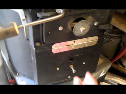

Hi, Kent! I was just thinking about this water heating subject, and I remembered our own Dan H did this years ago. Here is a link to the video he posted. the description of the video on YouTube has some details of the build.
[Wood fired domestic hot water heater ]
Thanks, Mike (and @dynamodan). That’s what I’d like long term. Our current water heater (electric) is between the attached garage and kitchen, near the center of the house. Fine with electricity, not not convenient for wood with the need for air and a stove pipe. I may, someday, try something more serious like Dan’s just outside the house as a preheater, and connect it to the existing system with pex. Not today, probably not tomorrow, but someday, maybe :slightly_smiling_face:
