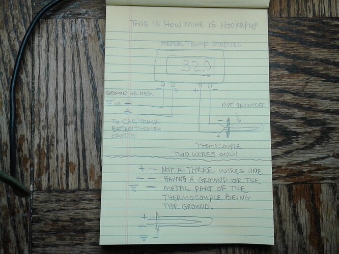

Hi Tom, I made a wire diagram of how my K type thermocouple and temperature read out meter is hooked up for my grate. It is the same for the hopper, cooling rails.
Hope this helps.
