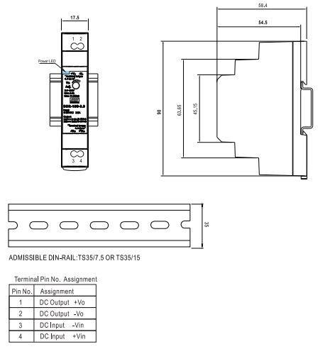

Now I would like to put an inverter in the truck to hook it to. Some where here, I thought someone posted that by pulling 110 v off the inverter and then converting that to 12 V DC they could run the thermocouples and the temp. readers, without the problem of a common ground to the truck and thermocouples. Does anyone have any information on that. I’m afraid my 12 v DC battery that I used for the TC readers has gone dead waiting for my to get things back together. TomC
Tom, Instead of jumping through all those hoops, why not try one of these. It is an isolated, 12 volt DC/DC converter. Connect the input to your truck’s 12 volt system, with a fuse and switch. Connect the output to your thermocouple readers. This thing is good for about an amp out, should be enough. Arrow is a reliable vendor. Looks like it has screw terminals. :slightly_smiling_face:

I’m with Mike. No reason crossing the river to collect water.

Thank you guys; Mike I understand the word “isolation” so it sounds like something I’m looking for if I go directly from my 12 v batter. I didn’t see any connectors on it. Does it have 3 or 4 connectors? If it has 3, I would assume it has a “+in”, “+out” and a common ground. If it has 4 then I would assume it has “+in”, “+out” and 2 individual grounds. The 4 wire, I could understand working without a common ground.

MeanWell DCdc_jpeg
Tom, as far as I can tell from the description, this dc/dc converter has 2 screw terminals to connect a 12 volt (your truck 12v) positive and negative. It has 2 screw terminals to connect your thermocouple readers to, positive and negative. The two sides of the converter are totally electrically isolated from each other. The converter mounts to a DIN rail, which is probably not included. (available at a good electric supply) You don’t have to use the DIN rail, or even mount it to anything, just tuck it in a corner or under the seat. It should stay out of the weather. There are many other choices to perform this function, I just picked this one as cost-effective and would do the job. I should get one myself and try it out!
