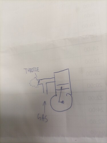

JO, lm thinking to not install any gas mixer at all. Something like this
Tractor idles on pure diesel, only pulling a tiny bit of gas just to keep a bit of draft on it. Mix is too lean to ignite. When you want power, give the governor throtle and the engine revs on diesel. Then start shutting the throtle valve shown on the skiz. The mix becomes richer and combustable, the governor start to cut down the diesel to stay on set rpm. Kinda how Tone does, only without an actual mixer.
How many gears does this tractor have? It seem it will be a much narrower RPM range than your truck. So it makes sense to design it that way. Across WK/Imbert design maybe that will heat up faster. One thing on a WK Gasifier is on starting it up, it helps to use a big blower that can move a lot of air. A small blower takes a long time to get things heated up. The preheated air off the exhaust is the other thing that speeds things up on a WK Gasifier. I know this first hand when at Argos wood gas meet up when I lost my preheated air capability. You were there that year Kristijan. 5 times longer to bring it up to running temperatures. It is not a race to me anyways on starting up. but facts are facts.

Bob, there is a steep downhill down the mountain that streches for 1.5miles continuously. I go WOT second gear pull starting the lit cold gasifier and at the end of that path l only barely start to get combustable gas, no power. Its a nother mile couple of miles of hybriding later that l can go 100% chargas. That engine pulling on it at WOT is one hell of a blower… But true, l have no air preheat.
