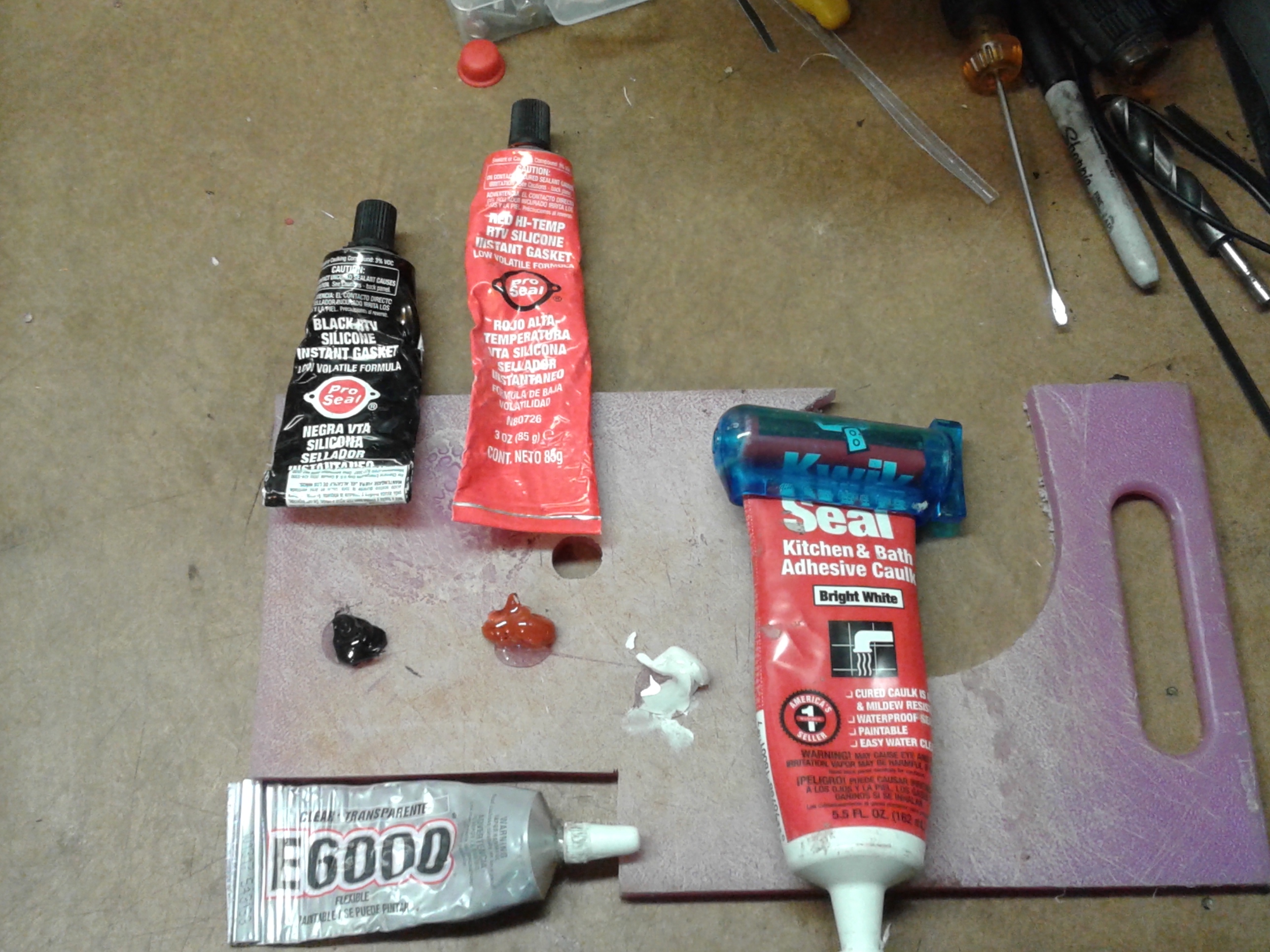

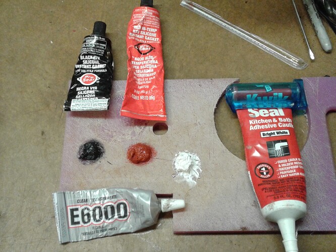

I wonder if shoe goo and silicone will mix together that would form a quit drying type patch glue. I will go and mix a test batch up and see what it does.
Ah, my tube tube of shoe goo dried out. But here is some E6000 glue very similar might be the same stuff under a different name.
Mix them up with equal parts.
Lets see what happens.

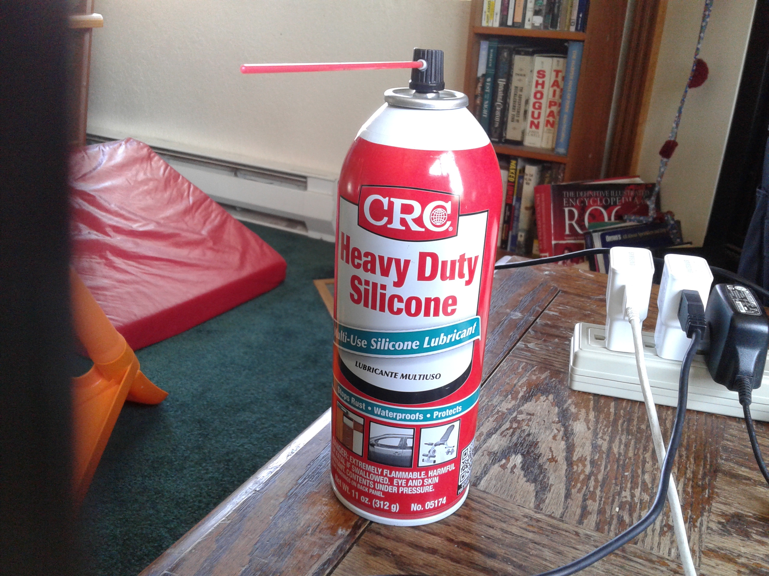

Hi JO, It seems on my throttle body for my auto mixer needs some lubrication on the shaft from time to time to keep it from sticking.
I have been using silicone lubricant spray in a can. It penetrates well leaves no residues. It cleans it when I spray it one too. This is NOT the silicone liquid spray tape for pipe joints threads. Here is a picture of the can that I use.

Thanks Bob, that’s a good suggestion. That kind off silicone is a really anti-stick lubrication. Also it should repell soot rather than attract it. Maybe the entire throttle plate could be sprayed with it to prevent buildup. I wonder what happens next time the torch is put to it.

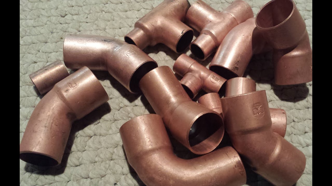

You can use Coke or most other soda’s for copper and brass as well. :slight_smile: I never added the salt before though. If you mix soda, milk and then add salt it fizzes up into a creamsicle looking thing.

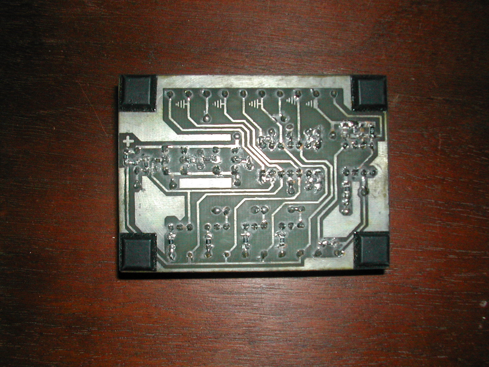

I had to make a bunch of these little boards. I etched them with ferric chloride, coated them with tinnit, and soldered the components on them. I got very tired of cleaning rosin of of them afterward. So I made sure everything was very clean using vinegar and then just soldered without any sort of flux. It worked great.
You just have to let it dry before turn on the electric and you are good to go. Any residual water can create shorts if you power it on when it is wet when you are have a populated board. Otherwise you are fine as you have demonstrated.
How are you doing the traces? I thought most people moved to cnc milling to avoid the hazardous ferric chloride. But both are kind of an art form and have their advantages and disadvantages.
