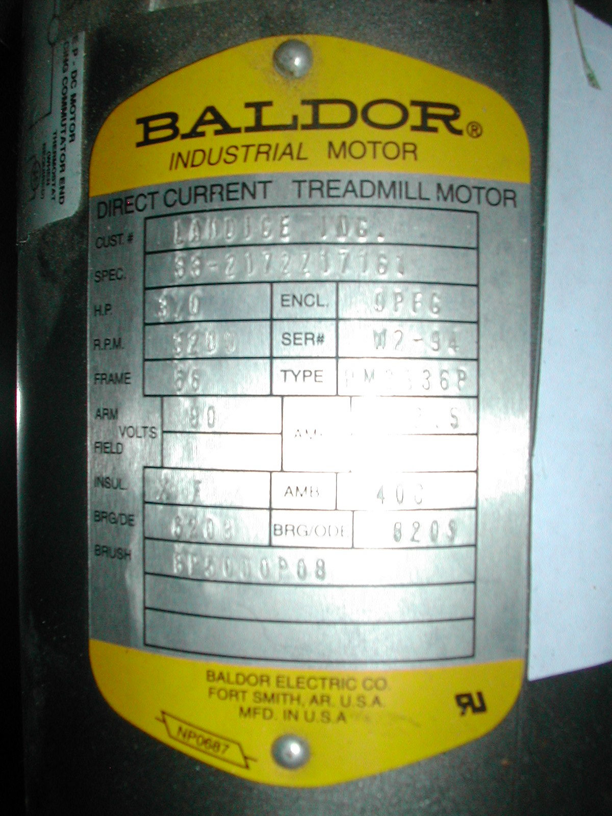

Manufacturers have been wildly exaggerating their horsepower claims for years, referring to “instantaneous braking horsepower”…
Which is meaningless, because depending on how little duration you calculate the stop, horsepower would rise towards infinity.
1 horsepower is 750 watts. Any tool or appliance fed on a 120v 15amp branch circuit (12 amp at 80%), can’t be much more than 1hp, the inrush current would trip the breaker.

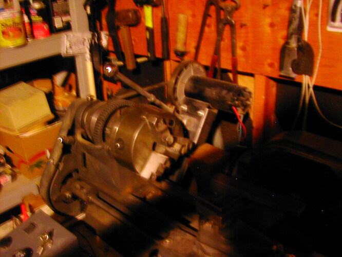

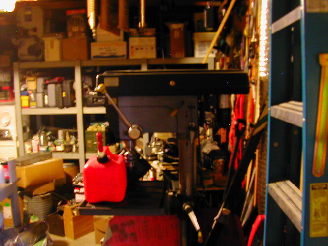

This is the third and oldest treadmill I have scrapped the motors out of. I repowered my drill press and lathe with the other two. This is the heaviest of the three at 39.5 pounds. It measures 14 inches long and is 4.5 inches diameter. I don’t have a dynamometer and I’m not about to build one just to prove something to you guys, so the world may never know. What I know is that the motors on my lathe and drillpress have served me very well. And that is what I care about. Just passing on what I think have been some of my sucesses. This could be valuable to someone. By the way 1 horsepower is 745.699872 Watts.
Lathe
Drill Press
Impressive RindertW,
You surly show that you are not just a prettyface/internet voice, but a real down to earth DOer-of-Things.

Hi Garry,
I talked with my friend who is an electrical contractor. He looked at your post and gave me a refresher about a bunch of things I had half forgotten. I didn’t want to talk before because I wasn’t sure.
First these treadmill motors are direct current. They use a motor controller to feed them current that has been rectified. The ‘inrush current’, as you put it, only happens with ‘locked rotor’ (not moving) alternating current motors that are connected to ‘mains power’. The stuff that comes into the house from the pole.
So then, our calculations become very simple. Power is voltage multiplied by current, P=VI. This particular treadmill came with a 20 Ampher slow blow fuse. So Power = 120 volts x 20 amps = 2400 watts or 2.4 kilowats. If we divide 2400 watts by 746 watts per horsepower we get 3.2 horsepower. The fuse doesn’t blow when the motor uses 3.9 horsepower for a short time because it is designed not to. That’s why it’s called a slow blow.

I am unfamiliar with this sort of treadmill. Does it plug into a standard 15 amp receptacle? Electrical code specifies a continuous current rating for a branch circuit at 80%, so P=ExI, 1,440 watts. A 20 amp will be 1,920 watts. Try running the microwave and toaster on the same branch circuit…
I buy the DC motor part, makes sense for the torque, and to avoid the inrush current. (Induction motor starting current is not from locked rotor, rather the rotating field in the start winding trying to near instantly accelerate the rotor. )
Anyways, I buy that the DC motors can be torque-ier on a given branch circuit (unless resorting to PLC’s). (Variable frequency drive). It sounds like a good obtanium item. But those numbers don’t jive.
It will trip a 15 Amp breaker imediately. It needs a 20 Amp breaker, minimum. Not perfectly certain but I suspect this was among the first treadmills sold to consumers, back in the 1980s. Slightly more modern ones would probably be more usefull to us. This one has a rated speed of 3200 rpm, whereas newer ones seem to be around 6000 rpm. New ones weigh about a third of what this one does. New ones are usually rated at 2 or 2.5 horsepowers. New ones don’t trip a 15 Amp breaker.
