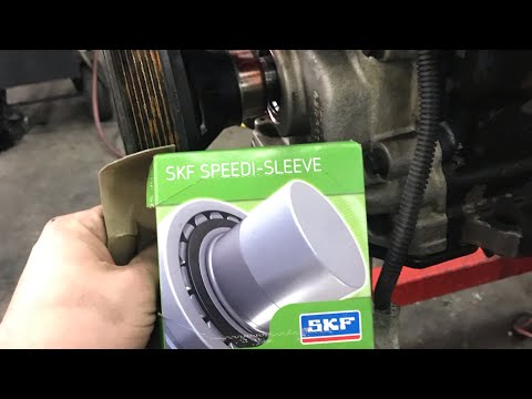

Nice tips Marcus, i see your gasket scraping tip also, nice tip.
Real nice trick Marcus, That is one trick i dont think i ever tried, I would drive a small hard drift into the edge by your screw hole, and knocked them out that way, But i like your trick much better, lass chance of damage the seal mount surface’s with your seal remover trick. SUPER-GOOD IDEA.
Yes, almost exactly the way I evolved to do seals removal too. Those front of engine high-milage timing belts replacements, if done well, you have a front crank seal, and up four cam seals to do. Gotta’ be fast, safe and non-damaging!
I’d cordless power drill a 1/32 hole first. Use short SS sheet metal screws and two opposing pry tools, for a back and forth rocking out. Marcus’s single screw tapping in does loosen up the seal probably better.
Ha! As Marcus knows DO NOT USE a bodymans slide-knocker tool on these puller screws! No “feel” at all to that. More often then not, you’ll rip the screw out and have to start over.
Extremely difficult to overcome the impulse of " Iv got the powa!" when using a slide hammer attachment, BUT, I have run into some instances where there was not a good area to get leverage with the pry bar and did use a slide hammer but it is a gentle tug not a sharp smack which as you said will very quickly rip the screw right out.
If I recall last time I had to do that method was a all wheel drive bmw? Front transfer case out put shaft seal. And I did pull the screw a few times before I got it out of there! Flat rate pay makes you work too fast some times…
