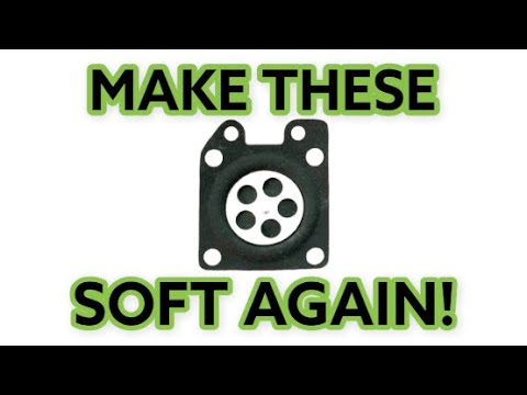

Method to bring back a diaphragm that’s hardened up. DOT3 or 4 brake fluid and let it soak for a few days to a week. A bit of a temporary fix and doesn’t permanently restore it.
Not to bring down this, but i’ve tried alot of different methods to soften those diaphragms, brake fluid works 1 time out of 20, i guess it depends of what type of gasoline they had been “preserved” in, ethanol gas is often no idea to even try.
Boil them in glycerine/glycerol (translation?) 20 minutes, with one drop of “seal saver” works 1 out of 10, it’s also good to soften up old rubber parts.
