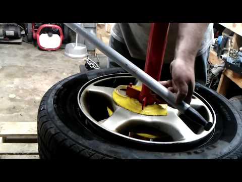

Here’s is my good-points selected out videos:
As seen he is a beefy guy; using his whole body - and not yet broken anything. In-line techniques.
This guy shows how to actually use the installer end (lifting to re-center) of the stock installer bar end. He, like me does not like the dish soap spray mix!! I use a soft wax paste. Won’t hot weather evaporate on you. Will not freezing weather freeze. Will not wheels later corrode.

JohanM at 8:18 minutes this fellow shows using your plastic “Third-hand” helper tool:
Very important. The missing step in most of the “this is too hard!”, “it broke/bent!” videos.
I am using strong plastic spring assembly clamps for off-side pushing down.
Others show using C-clamps. Vise grips with rubber strips.

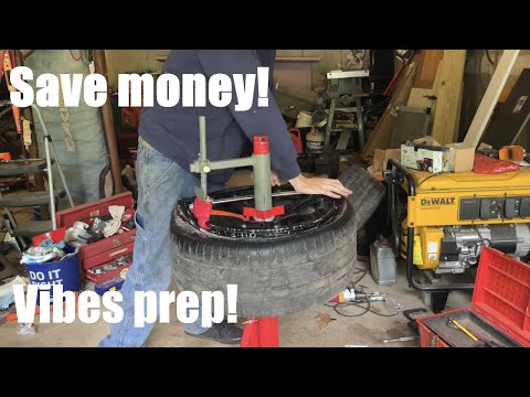

Hi All,
I just found another way to do light-touch on alloy wheels:
Be patience with this guy until he gets along to showing installing. He’s showing a bunch of good tricks.

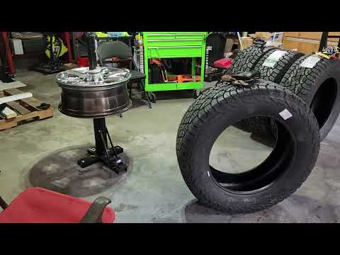

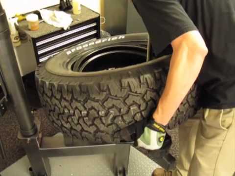

Here one from No-Mar themselves doing a B.F.Goodrich A.T. KO off of a Hummer. These BFG’s have triple ply sidewalls with a moulded on raise-rib rim protector. A bit challenging to do.
Watch specifically this guys very selected use of mounting paste-wax. Once I used paste; so much easier; needing so much less force; I never went back to a spray for mounting:
Pretty good for a mere “motorcycle” bar tool, eh?

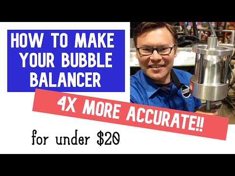

I’ve watched a lot of videos now. Mostly how to fix/improve new low costs static bubble balancer Chinese machines.
This video shows a technique I’ve never seem. Well worth the time to watch and think about:

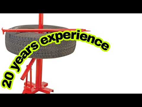

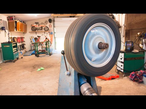

I found this video a while back and thought it was interesting.
Your system works for you. I bought a hf tire change post and bubble balancer. But I felt a lot better about it after using this guy’s idea.
These are all very good videos to watch if you’re considering balancing your own tires, thank you Steve, Brian and Rindert. When I bought the duckbill for tirechanging which by the way I found three styles of, after watching lots of videos I figured out which seemed to be the one to go for and it is the one that has a slot opening where the rim goes. It is the one they use in the videos that Steve put up.
