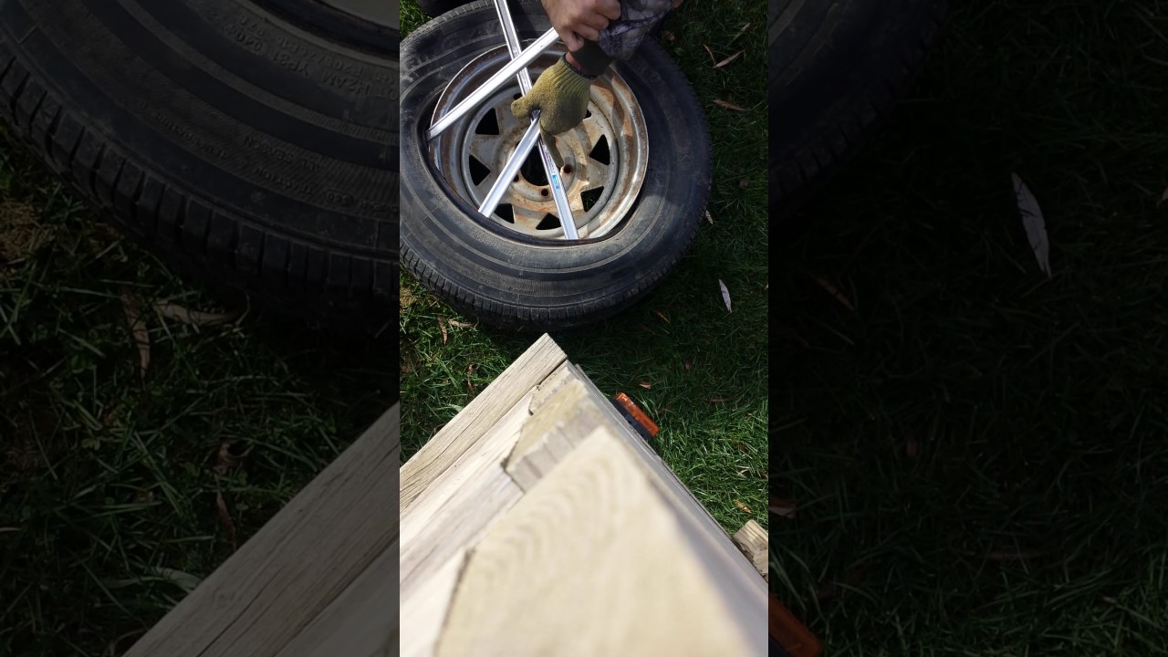

I actually like the older; on the ground; on-your knees tires spooning approach better. Less tools. Much more about learned skilled techniques:
Watch. But, especially listen to his teaching words. Great editing on this Educational. Better imho than any sports entertainment program.
Then this guys 1st of four wheels and tires videos:
One he covers home bubble balancing. After covering post stand work.
The best thing converting myself from a power equipment fully set up Shop-guy was buying two of the Harbor Freight tire spoon tools. I should have bought three:
These are very affordable and made well-enough. Next time in their store I will buy that third tool. Plus two more sets of three. One each set-of three to go into the back of our primary driven vehicles. Ha! Make good tent stakes. And other ‘needs-must’ usages.

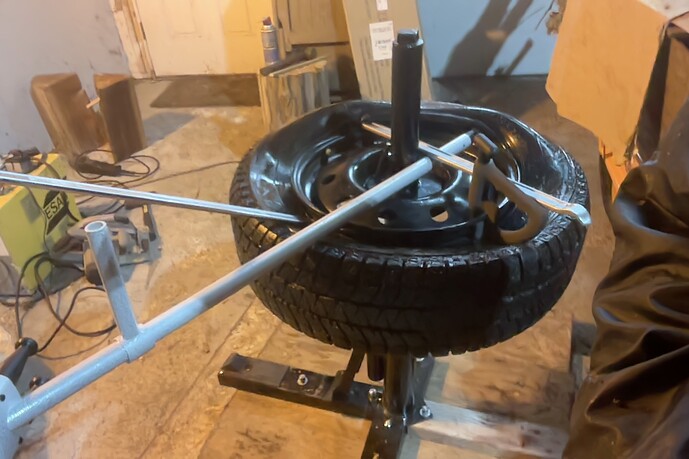

It did help to bubble balancer check the replacement bare wheels and mark for heavy side. Then with the new yellow dot light spot marked tires “match mount” the sets:
I consider that H.F. supplied mounting end bar a fail.
I know other videos are up forcing it to work. Horseing poor tires like I’ve seen videod tears cords. Chunks out beads.
Extensively ground modified I can make it work on soft single ply sidewalls on 70 and 65 series tires.
No way it would completely install my Bridgestone Blizzaks. Not without excessive forcing. I could hear cords breaking.
I’ve tried to picture the problem:
This straight bar held along side the large diameter center post then cock angles the straight on head claw and bump ramps. Head forging needs to be angled formed biased.
Ot the bar tip torch heated and then angled. And a flat plate welded to the round bar to prevent it from twisting.
I had to finish installing each time by spoon-barring the final seating.
So do the duckbill, rotating arm conversion improvement and save a lot of grief.
I’ll keep grinding away at the head with every try-install. Can’t hurt NFG.

Yes Steve, I modified my H.F. changer a few years back. Makes it a completely different machine. You need duck bill, and centering cone.
Ive had an hf tire changer for some years now.
First off, i have never in those years balanced a tire. Never noticed a problem. Modern tires are pretty good.
One modification i made to the bead breaker. I had trouble with it sliding back away from the rim. My solution is to weld another pivot to the main post, then add a second parallel arm to the bead breaker. It can now only move straight up and down, and not kick back. Works great!

I did see in one video a de-mounter modified with an added pivoting link as you describe. Yours? I could not find that video again. But frustrating for me; I found this one:
This fellow has used his so much he’s worn off the thick powder-coat paint! I sure did stop view; and enlarge, to see if he’s modified his installer end. ??? Or, if H.F. had changed Chinese manufacturers; and once had a different end forging!

Steve, im pretty sure i never did a video of my modification. Might have posted a still pic at some time.
Anyway here it is again.
