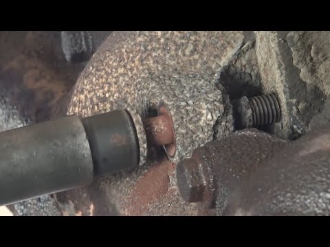

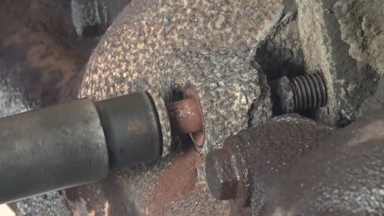

CodyT. just fought his way through old rusty exhaust manifold to header pipe clamping studs.
Here is a video that recommended loaded up well worth watching.
Hang pause at 10:24 when he realizes he missed one on his initial breaking-all loosening:
At 12:50 listen to his advice to fully coat the bolt shoulder/shank with anti-seize too on installing. How I learned to do it also. Keeps from re-occuring heat rusting stuck. Figuring you will be that next-guy; removing.
What trick I will add is on studs threads and bolt-throughs with exposed threads DO take the time to SS toothbrush off as much you can rust corrosions. Left on, these will break loose, powder and jam up nut removal.
And a loosened wanting to then bind like this guy shows twice: after heating here is the time/place to touch melt in some crayon wax.
I hadn’t thought of a crayon, but I know candle wax works real well. I put wax on lug nuts. It makes them easier to get off and it stays on there for a really long time, so the next guy isn’t going to break a stud or anything like that.

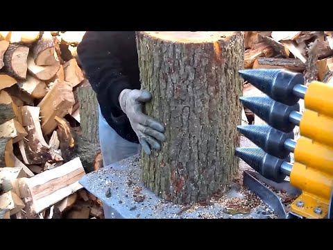

Could not decide where to post this this link so decided it may as well go here .
The winner is the rebak at 16:19
I like the Rockin’ motorbike buzz-saw, right at the beginning. Caught my attention!
(I could build that!) :cowboy_hat_face:
Edit: at 01:28 looks kinda familiar…
You could improve on it by making it front wheel drive, and use big coil springs like they used to use on the playground rocking toys, and maybe move the foot pegs back so you can stand on it and rock it. Then to keep it safe, and to keep with the motif, you would have to have long chopper front forks with like 3/4" thick metal fenders. Having someone else rocking it is kind of lame.
Then you too could be a star in a almost killer viral youtube video! :slight_smile:

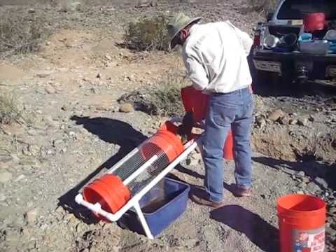

Screener for soil or charcoal could be improved with screen size options.
I have a trommel that is somewhat longer than this one. I use it mainly for separating the finished compost from the leaf mold. I haven’t found it that useful for the amount of char I do at one time. Same thing for worm castings. I usually save my wood stove char and ash in a 25 gallon metal trash can and then sift it and grind it when that is full. By the time I sift out the ash and then grind the char and separate the fines from the fuel it just seems less involved to do it with boxed screens vibrated with a roto hammer. I have been thinking about building two smaller trommels like the one in the video with quarter and eighth inch screens which would work for char and castings. Takes about a hour to process the 25 gallons the way I’m doing it now which includes grinding by hand.
if it is “good” brittle char, you can drop a rock or something to tumble in the trommel, and that will break up the char. Mine was that size, but inside I had another ‘large’ screen attached to a bucket lid with about a 3" gap between the screens and I used the bottom part of a water bottle filled with cement but rocks worked as well. I turned it with a 1/6hp 1750rpm motor.
The main issue I had was the hole wasn’t big enough, after I left a 3" gap around the outside, it was too small and the other was I had too many brands so I had to stop all the time to pull them out. Otherwise even with my crappy assembly it worked well with good char.
It skips the grinding and sorting twice. But it is pretty easy to screen right into a wheelbarrow as well.
Always more than one way to skin a cat,

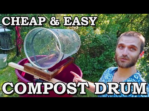

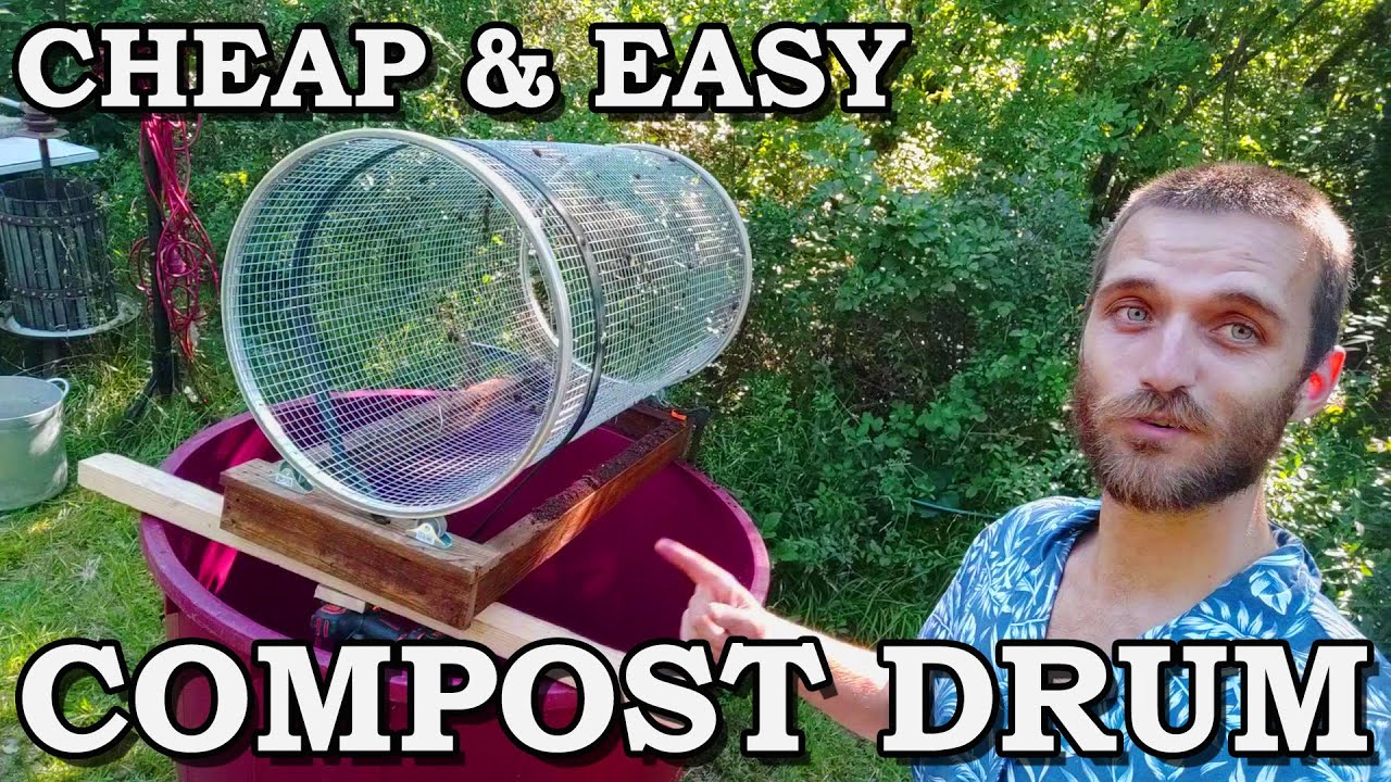

Need to start doing this with all of my solid topped plastic drums I’ve gathered from the old job. Might be a good way to sweat some moisture out of wood chunks if you have the black drums.
Great Idea CodyT.
I have 2-3 that did have the tops cut off, then that cut off top discarded. Land leaser cleaning up I got them this way. They always go very not round then in any kind of open topped usage.
The top flipped; flanging-lapping, would keep them round.
Most of my intact barrels on the normal inset top do have factory drilled small drain holes.
I had to plug these winter raining water out in the open catching/filling to let the rain water caught; pool, and drip-fill down in the open bung holes. 88" to 122" of rain a year here they would fill by sometime in December-January. Some barrels I even had to V-notch the raised bung hole edge for gravity filling.
Cut off and flipped over a fellow just needs to edge drill his own perimeter drain holes.
If they are white in color spray painting them black will work too.
bike rims are a good idea! you could fit the 5 gallon bucket version inside the bike rims as well.

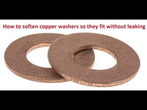

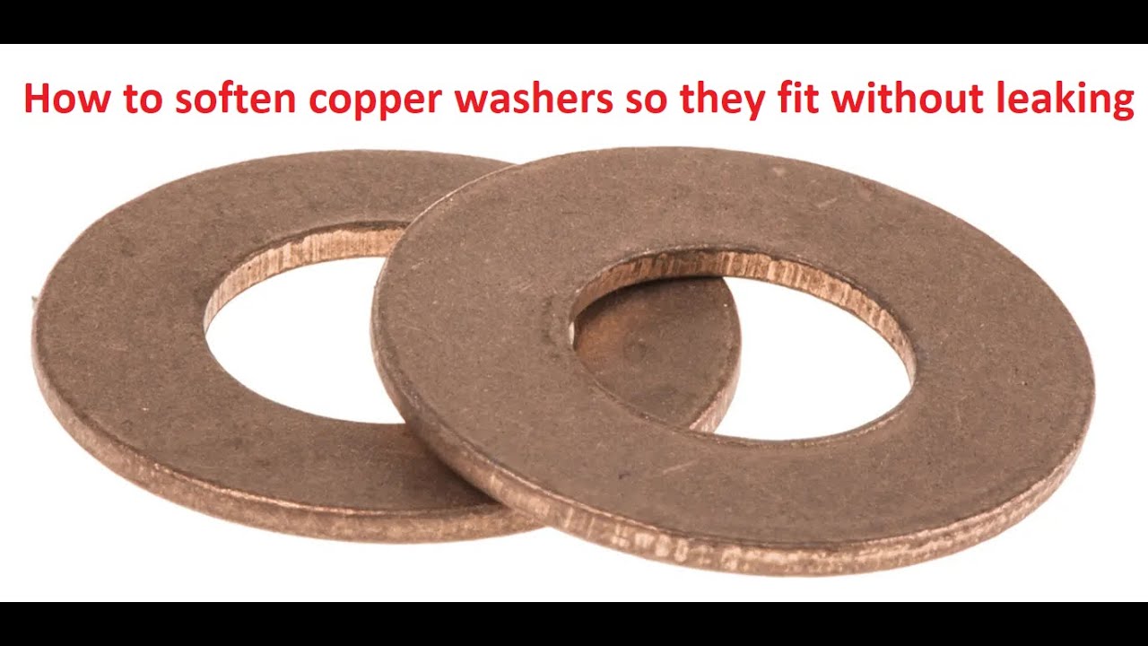

Here’s a way to re-use copper plug gaskets.
