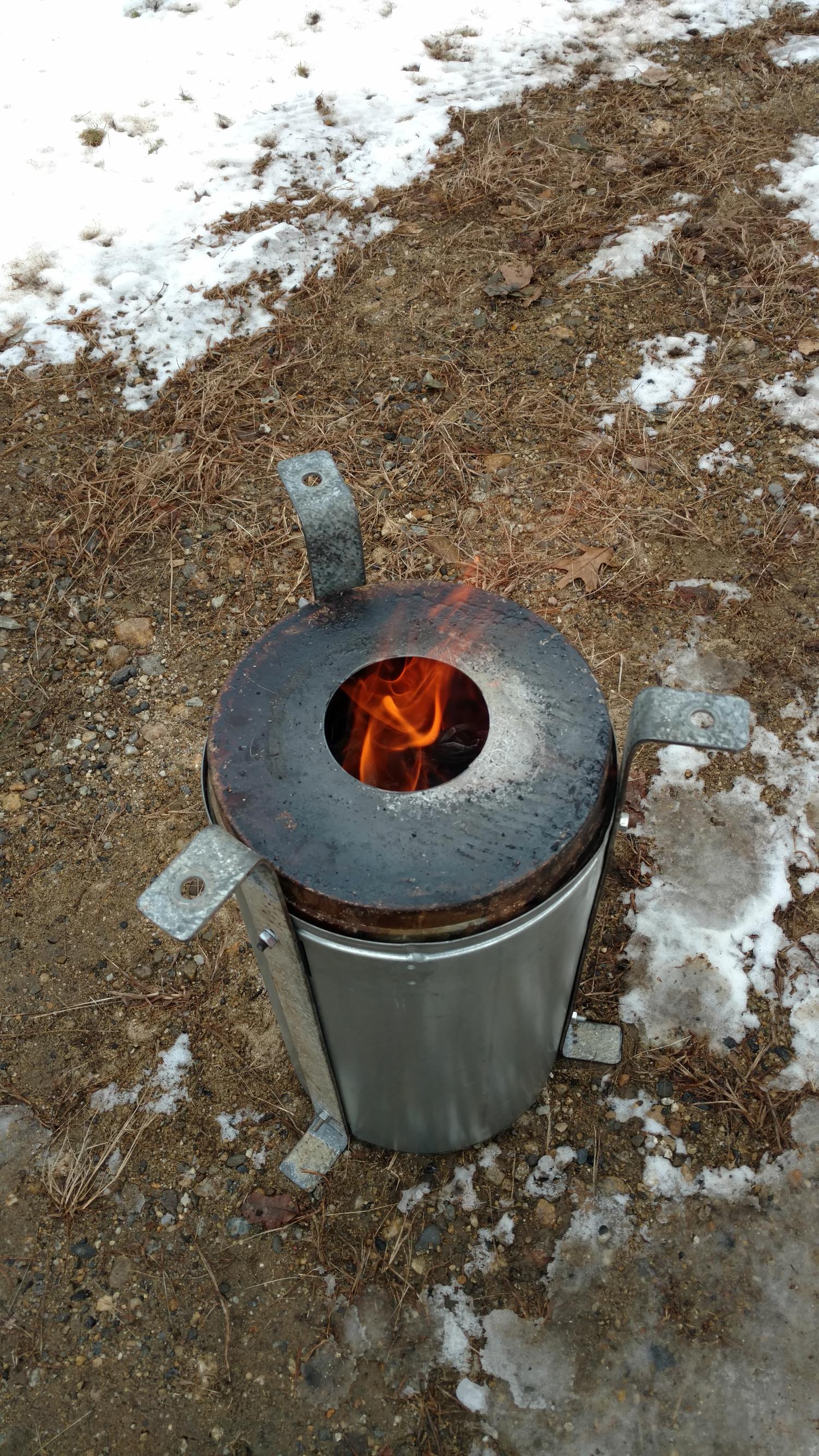

Another option for creating charcoal pellets without wasting the heat energy is to use pellets in a TLUD (aka gasifier) cooking stove. When flames die down, close top and bottom to cool charcoal or dump glowing char into a covered container for cooling. My latest version below is made from double walled flue pipe that has a SS liner, 1" airspace and galvanized outer shell:
