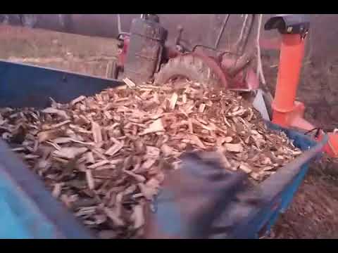

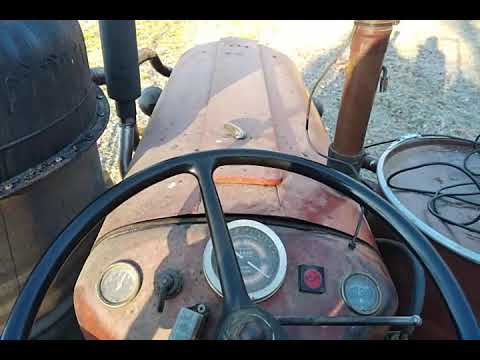

My son Domn and I already concreted half of the floor slab on Saturday, well, the sand is quite coarse, but I decided to crush the remaining sand more finely, I adjusted the jaws of the “Razinger”, fired up the gasifier and finished the job. I am always surprised by my Fergie because the mill set up like this is very difficult to drive. In the beginning Fergie had big problems, then I tried diesel fuel, but it was not much better and I returned it to wood, well, after some time of operation with slow dosing of sand, Fergie recovered and turned the mill. In the afternoon it was hot to work in the sun (33°C), but we worked at full capacity, there was not much condensation in the funnel, maybe 1 liter, and there was also liquid in the cooler and filter only for a sample, the gasifier does its job well . This today’s attempt to compare the power between diesel fuel and wood gas confirms the theory that the torque or power of the engine is almost the same.

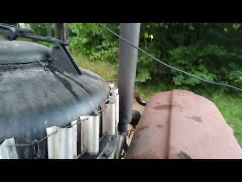

It’s time again for the “service” of the gasifier, 50 operating hours.
This time I also removed the cover to see what the condition is. Everything is in very good condition, …
Now I’m testing the operation on larger pieces of wood, it works well in low loads, but it takes more time to go to full power,…
https://youtu.be/k52hHEtWQZc?si=E7EJp82AxUhvALVZ

I got a throttle valve from a Renault Clio 1.2 small car at a local junkyard and installed it on the tractor this afternoon. The diameter of the valve is 35 mm, the previous one was 45 mm, I hope that the low load regulation will be more sensitive and precise.
