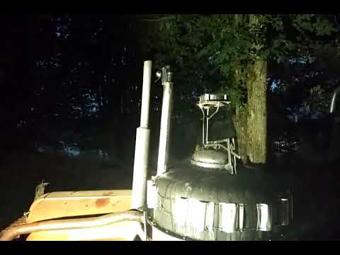

Mr. Wayne once wrote, “when you drive on wood gas, your tires wear out”, but I say when you have a tractor on wood gas, you will have your hands up to your knees, work,… work,..
I recorded this the day before yesterday, nothing surprising, just a standard procedure, well, I blew the gasifier a little too briefly before starting,…

Since I’m making silent movies like Charlie Chaplin, I’ll add some more subtitles:
  • the tractor worked for about half an hour, until I reached the forest, where I was sawing and loading wood, this lasted for 3 hours, in the meantime I occasionally open the lid to keep the fire alive
  • when starting, I first blow air on the nozzles while the chimney is open, so a larger part of the water vapor comes up and does not cool the heart with charcoal
  • then I close the chimney and wait until I get combustible gas, install the gas pipe on the filter, which is filled with gas, then turn off the blower and install the pipe from the filter on the gas mixer
  • when starting the engine, I set the air flap (the lever I turn) to a fairly closed position, the lower lever (the lever from the bike gearbox), to set the centrifugal regulator, I set it to low speed and the upper throttle lever to 1/4 opening.
  • the gas is bad at the beginning and a bit moist, if the engine inhales a full amount of such a mixture, it does not ignite, probably due to high compression and moisture, so I try to adjust the levers so that the cylinders are only partially filled with the mixture, which allows ignition
  • while I adjust the levers and try to start the engine, the steam presses down into the hot zone and cools it down, and the gas becomes very bad, so it occasionally happens that after a successful start the engine shuts down again and the process has to be repeated :grin:

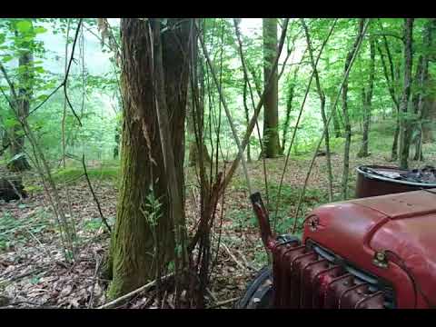

In the afternoon, me and Fergie worked “hard”, I still use the remaining heat to dry the wood, which I filled to the top and to repel mosquitoes,… :grinning_face:
