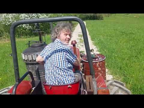

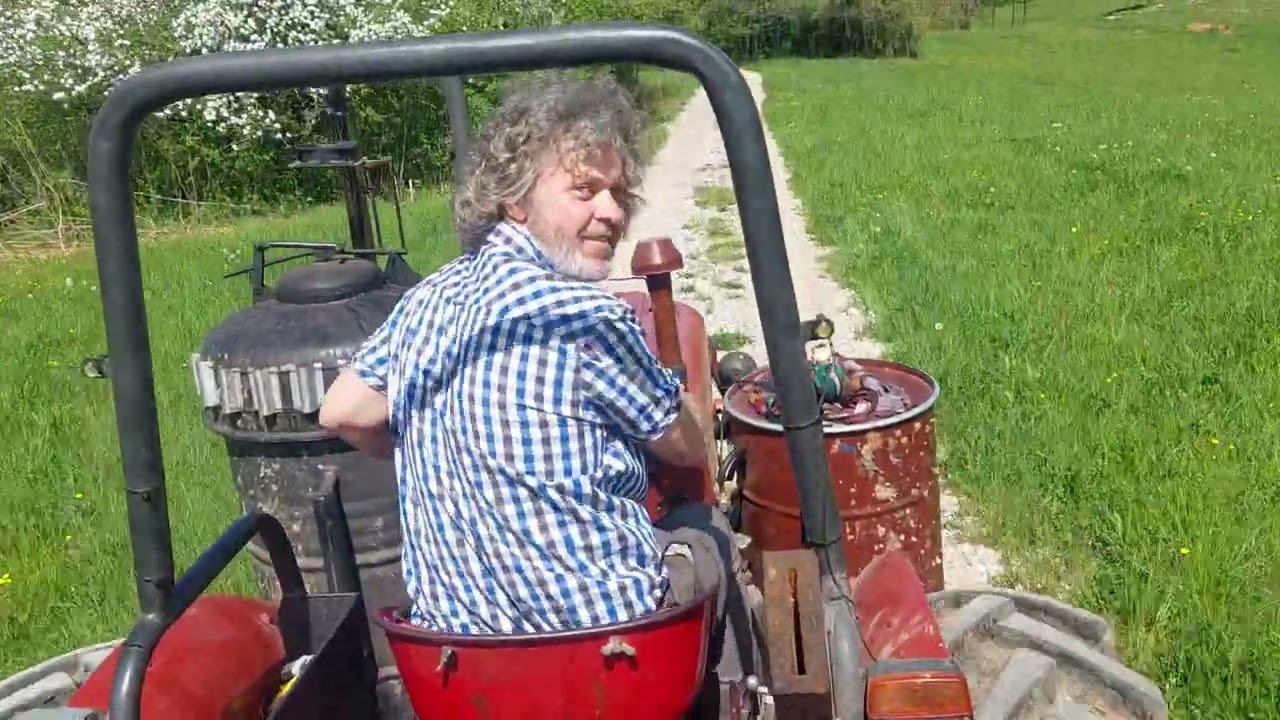

Today was a wery pleasant sunday, brother and l visited Tone. We bothered him for way too long but time sure flyes when in good company. He took us on a sunday joyride so hop along, lets burn some woodchips!
Thanks for the ride ! You made me smile through the entire trip :grinning:
Me and my Fergie have camera jitters, as soon as Kristjan called me, we both chatted… otherwise it’s nice to hang out with friends with similar views… time passes too quickly :grinning:

Thanks Kristijan and Tone for the ride. Smiling ear to ear here also.
OMG it’s green. Stunningly beautiful surroundings.
Hey Tone. What does the Kruster1972 on you video mean. If the 1972 is your birth year then I have two daughters older than you. Now I really feel old. Say it isn’t so. :pleading_face: :pleading_face:
What Wayne and J-O said, big smile :blush:
Tom, if you have daughters older than me, you were really hardworking in your early youth (of course your wife too),… :grinning:
Not a lot of hard work involved Tone. Of course if I had a time machine I’m pretty sure I’d go back and get the snip job. :scream:
Tom, you don’t want to go back, think, with the good things come the hard ones, you’ve done and survived so far, I don’t want to go through all that anymore, this time that is now is the best for all of us, just don’t we can waste it. :+1:
