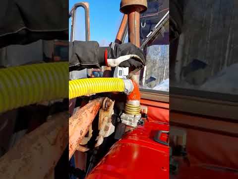

A day of testing, I installed a gas control damper, connected a trailer with a gasifier and connected the gas to a flexible hose, …
https://youtu.be/cE-iCMls-Hc

Congratulations Tone
Thanks for the video :blush:
That was great Tone. Your landscape looks so much like ours I would feel right at home.
Another farm tractor, ready to work!
Marcus, I was just testing the operation, I “borrowed” the gasifier from the cogeneration, I will make another one for the tractor, although I am tempted to temporarily install it on the tractor, but I’m afraid it will stay here, … :grin:
Very good video, Tone :+1:
That woodgas tractor vill be very useful. How much diesel, in %, do you eatimate would be required in avarage operation?
remember my temporary wiring for my pusher blowers dangling around in the bed of the truck? I have a saying for that its called “temporarily permanent” :rofl:
Yes, the diesel fuel is limited to about 10-20%, if before the consumption was 3-4 l of diesel fuel per working hour according to the meter, now it should use 0.5 l, but I must say that when I was testing it, it happened that the engine was running with the diesel fuel closed, which surprised me very much. However, doing so risks destroying the diesel injectors.
