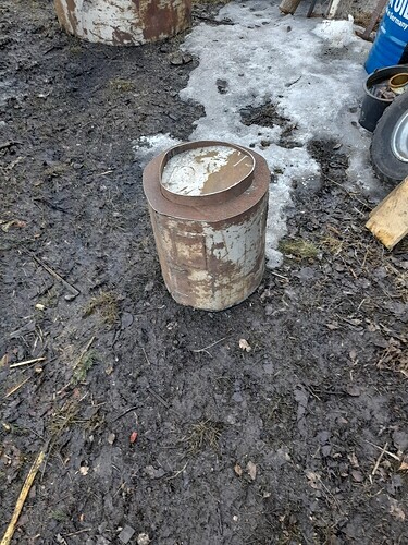

Looks good but whats the nozzle circle radius? Distance from one nozzle to the opposite one
Yes, the biggest difficulty is that it becomes quite wide, and thus very heavy to bend. I’ve gotten to it somewhat, but probably need to work a little more on both inner and outer tubes.
That is why I was thinking you might need a lever of some sort. You are almost making me feel bad, I can’t get thinner material that round. :laughing:
I thought about 200mm in diameter, yes, I’m probably trying to make a plate, instead of the cone, but should I not weld it in the tube?
Hmm, 200 might be a bit big. Depends of the size of your wood, ofcorse.
My Mercedes had 2.3l engine and a 180mm nozzle circle, and drove best at 1700 rpm. Thats comparable to your situation. However, for my Mercedes this was cruiseing power, and for you its preety much max power.
But hey, just make the nozzles threaded! You can easyly change them with longer ones.
Welding. Im all for that. I weld EVERYTHING. But after the hearth. You might need to replace some things. If its all welded, its harder. Also, the parts inside go trugh incredible heat stress. Its best if they can move and breath a bit.

Like Kristijan said, what I did for my upcoming gasifier is I cut a hole in my tank hearth for the restriction to rest in.
You could weld in a heavy shelf to the tube and make a restriction plate that will seal with the ash.

What does the diameter of the fire tube really mean?
Does it matter if it is 250, 300 or 350mm (10,12 or 14 ")?
Is it just the diameter between the nozzles that matters?
Jan, yes. The place behind the nozzles gets burryed with ash and charcoal. The nozzle circle is the only important measurment
The gasifier for my tractor will have a diameter between the upper nozzles of 350 - 400 mm and between the lower nozzles of about 150 mm , … at the moment I am of the opinion that the lower ones will always be active as they are closer to the restriction opening where the vacuum is higher, and the upper ones will start to let air in when the load is higher, they will also take care of any bridging. I don’t expect wood chips to stick , as the walls of the hopper will be heated with gas and insulated outside, so the tar can stay liquid and the fuel doesn’t stick, at least that’s what I’ve noticed with this gasifier I’m using. The condensation zone will only be in the upper part where all the steam rises, if necessary I will cool this part with an electric fan.
