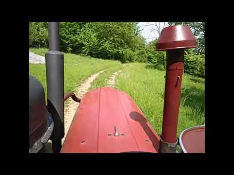

Today, work went on around the tractor towards the end, welding the connections on the filter, condensate outlets, sealing the hot zone with ash, filling the filter with hay and fine planing and under the top at the exit installation of a used paper filter, …

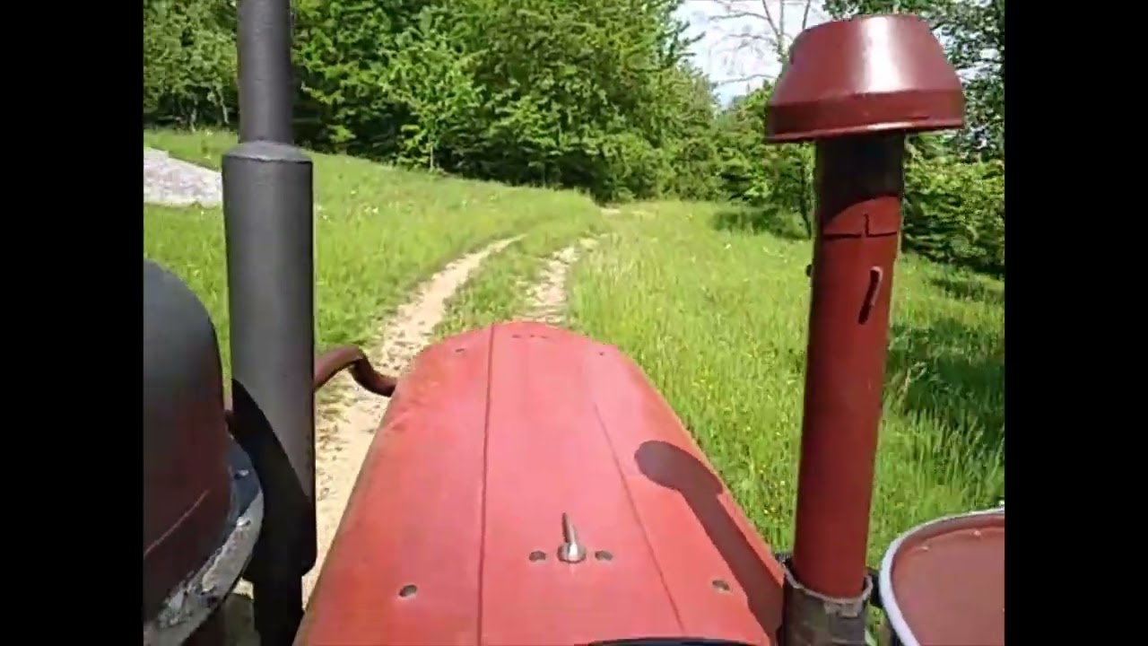

I tested my tractor yesterday, for good use I have to win that 75%, or maybe now 74% of the knowledge … :grinning_face::fire:

Nice, was very fun to see that you made it work so well. Did you have any problems with the chips, that it hung?
Very nice gas flame.
Jan, so far there have been no problems with this, otherwise it only worked for a few hours yesterday. I intend to surround the lower part with a welding carpet and add a non-return flap to the air intake.
