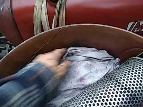

a really nice plane field you have, what seed you make there?
how much ccm your traktor has…?
hay filter like wayne`s , renewable material is great…

Hello Giorgio, say hello to your wife and son and tell her to cook a little better lunch, and you will start converting the tractor, :grinning: … by the way, my Fergie has a 3-cylinder 2.3 cc engine, and in the field I plant onions, beans, peas, some tomatoes, carrots, … and in this part of the video, my son and I planted corn yesterday. Well, a filter, below is hay, in the middle fine oak planing, and on top again a layer of hay, …
