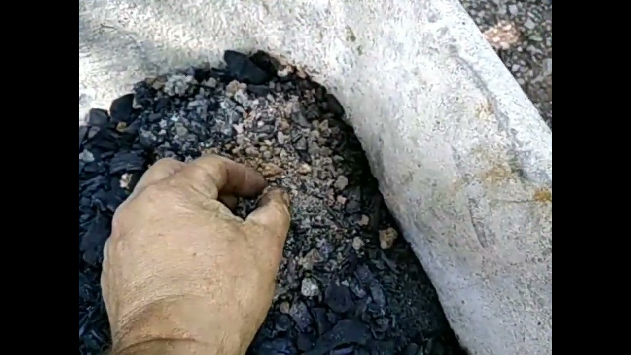

Curiosity didn’t give me peace, but I emptied the gasifier, a lot of charcoal and covered the bottom with charcoal and also brown pieces of ash… the lower nozzle is undamaged, obviously this construction works, maybe a more massive nozzle with a little bigger would work even better diameter, which would expand the glowing area a little more and thus reduce the temperature to prevent the formation of ash lumps.

Removing all of the spacing high melting point carbons from the mineral ash is your real situation. Either lower the temperature; or, fluff-stir the ash particles would seem to be your only ways to not clinker fuse form.

There is plenty of motor fuel, Fergie works almost every day, 90% wood 10 diesel fuel, he has done almost 70 hours on wood, now things are clear. But after changing the restriction opening, I have the feeling that the ash is retreating, the resistance in the gasifier is small, the gas is good and strong.
