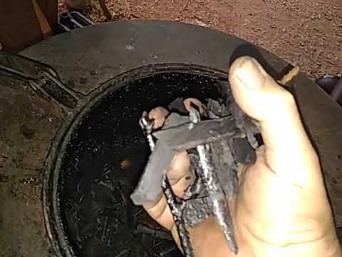

Here I took a picture of what the fuel looks like in the hopper, the small pieces are completely charred already high up in the hopper, I really don’t miss charcoal in this gasifier, obviously a heated hopper has a good effect on the pyrolysis process,…
Tone the main benefit you also have is you still have a top part to remove water from the hopper. The old Imberts without a monorator would get uneven drying.
That is just astounding how small of feedstock you are running. All my siftings from the chunker would be fuel in your tractor, your almost running on what I would consider to be mulch! Have you tried larger chunks to see if there is any difference in run ability?
Marcus, also the bigger pieces co-mixed between the fuel, but I didn’t do the selection, I just control that there is always some fresh fuel, which creates a humid atmosphere under the hood, which cools the process, prevents tar condensation and creates strong gas. Namely, water vapor is lighter than tar gas and thus stays above
You wrote very well in the adjacent thread and so did Steve….![]()
Tone your gasifier really does make a lot of heat, I think you’ve written in other topic, “by a razors edge”. Not a single bit of creosote once you reach the nozzles. I don’t think Tar even makes it to the nozzles it must be baked away before!
How are the welded together bearing races holding up?
Cody, the conversion of tar gases is probably taking place already above the nozzles in the glowing coal, as I think it requires a lower temperature than for the conversion of water vapor and CO2. The welded ring of the bearing is located in a hot ember and becomes glowing and soft, so there is no fear of the weld cracking, it heats up slowly and cools down slowly.
