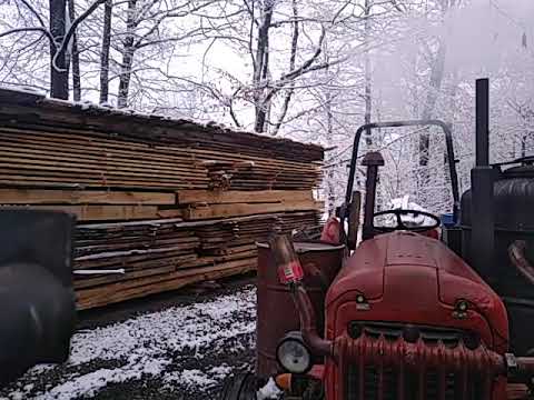

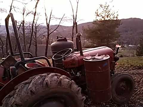

After changing the oil and the restriction opening, the tractor has worked for approx. 10 working hours, the gas is very strong, the setting of the air damper should be more open for more air, there is less resistance through the gasifier. I used the tractor to plow the field and drive the stone crusher, I am very satisfied with its performance, and I wish you all the best in the New Year.

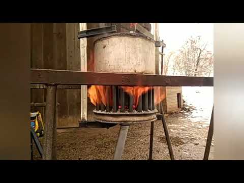

Joep, with this video I tried to show how this construction of the hot zone works, how the lower part glows around the lower nozzle and how the ash blows out. I have to say that this cordless vacuum cleaner has a rather gentle suction. You can also see that there is no fear of running out of coal, because the upper nozzles do this conversion efficiently, but then there is still a long way down through the glowing coals,…
I tried working only with charcoal and then with wood, the difference is more than obvious, I’m not saying that there is no flame with charcoal, but when the wood starts to gasify, it’s a different picture.
