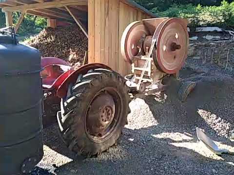

Tractor with gas?
Do you have to get them moving by hand or will that PTO get them spinning from a dead start. That’s a lot of mass.

Tone, can you set those jaws closer and run it through again to make fine sand?
