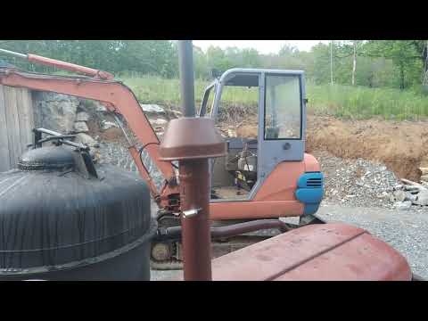

I installed a new ignition coil, I also connected a pipe for vacuum pre-ignition regulation from the intake manifold to the ignition distributor, added an on/off switch for the ignition,… the steering wheel mechanism had a lot of play and the ride was unfavorable at “high speed” " ", well, I somehow managed that too,… this is a recording of the engine running,…

20-25 seconds just idle running on filter barrel gas!

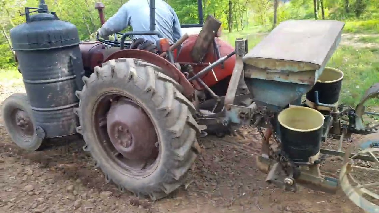

Today I drove the tractor for fun, well, among other things, I passed a power test with diesel fuel and wood gas on a steep forest path. Diesel fuel is stronger, and wood gas is not far behind, when the automatic gas mixer is installed, the “match” will be fierce :grin:
