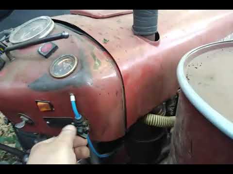

I did a test drive today, I loaded the cut grass and drove it to the landfill, it made four uphill runs and it worked for approx. 1.5 hours mostly without load, while I was loading the trailer,… probably this is close to the ideal regulation
Regulacija obratov motorja na lesni plin - YouTube

I think I owe you a short report on the operation of a 100% wood gas tractor.
Starting the gasifier and warming up the engine to stable operation takes about 10 minutes, during which time the tractor operates in hybrid mode - with pilot ignition on diesel fuel.
The operation on 100% wood gas is very smooth and fluid, the ignition time is set a few degrees before the top dead position of the piston, the vacuum membrane on the ignition distributor increases this by approx. 25°, the centrifugal regulator in the distributor also slightly increases the ignition angle.
The gas mixer does its job really well, especially at very low revs, when the engine pulsates the mixture, the result is very good torque and power, so I recommend its use, especially for single-cylinder engines.
The engine of the tractor has a working displacement of 2.4 l and when running on diesel fuel it has 35 hp (26 kW), at 2000 rpm, this would mean that it has 125 Nm of torque, I have a feeling that it reaches 100 Nm on wood gas and a power of 21 kW (28.5 hp). Is my feeling deceiving me? I’ll have to check that by throwing it on the generator when I get a chance.

Rindert, thanks for the contribution, apparently I’m getting back to the results that I achieved and measured on my generator, which is that an engine with a working volume of 1 liter develops a power of 10 kW at 2000 rpm (torque - 48 Nm), this means that the tractor could reach 24 kW (torque - 115 Nm).
As an interesting fact, I should say that the diesel engine reaches a torque of 65 Nm per 1 liter of working volume and a power of 13.6 kW.
The gasoline engine achieves a much higher torque, even up to 100 Nm, but if we take the Volvo 740 2.3 as an example, it achieves a torque of 185 Nm, or 80 Nm per 1 liter and a power of 16.8 kW at 2000 rpm.
This is quite realistic data for comparison and to know what to expect from wood gas engines.
