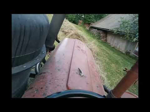

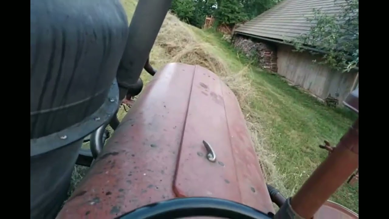

I took a day off and had some more “fun” to collect and transport hay, well, some highlights of the day are recorded for our forum,…

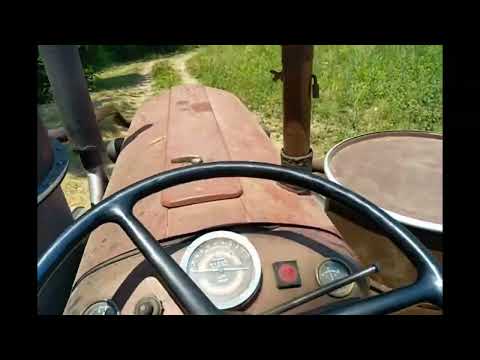

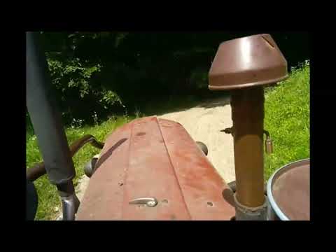

The tractor has been working a lot lately, well, I mostly “feed” it now with torified wood, the gas is strong, there is a little condensation from the funnel, and there is no moisture in the front of the refrigerator.
Now, when it’s sunny and hot, the torification process takes two hours and I get about 30 kg of fuel, 60 kg in 4 hours, which is enough for 4 hours of operation at full power, or 6-8 hours of moderate load.
