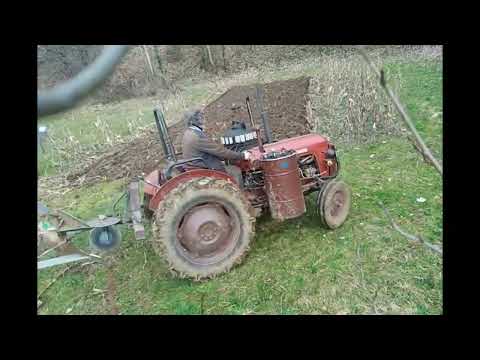

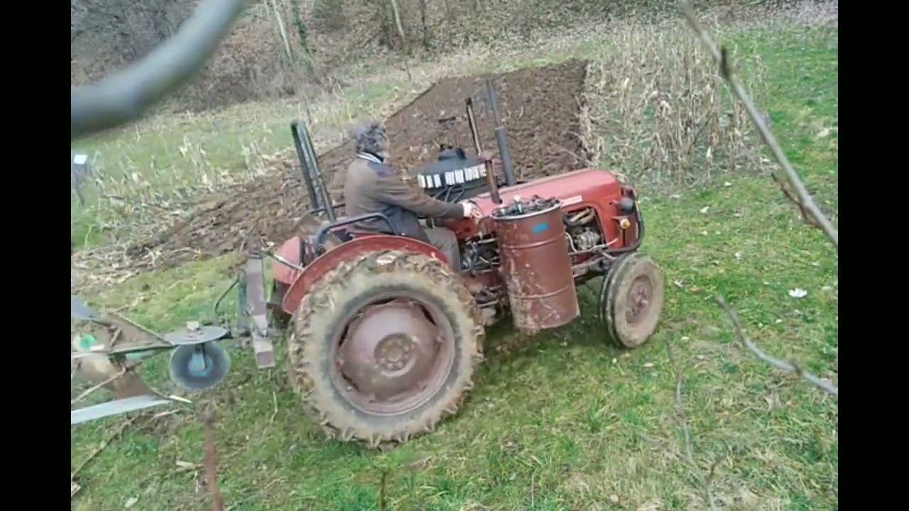

It took me a few minutes to install the camera, while the tractor was running at low load, well, on the first drive uphill, you can see the power drop, but it can still pull the plow.
The draining of the condensate that accumulated during the work is also shown, and I also recorded the engine stopping…
thanks, tone for this nice video…last year you have plowed the earth to the right side, this year to the left side…this is exact the right plowing to keep the earth on the place…
here farmers with the mostly irregular shaped fields are plowing always to the right side, in the midddle the ground becomes always deeper and with a while bad ground comes to the surface…
i love the smell of fresh plowed earth…and the shining plow…
