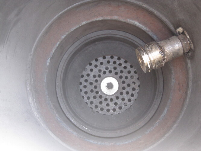

here we modyfied a bit our first gasifier (summer 2020)…the primary air tube was situated before inside of the hopper - advantage: easily to make modifications of nozzle hight…
BUT the heat conduction to the outer shell not exists and heat convection is only with the pipe, and seems not enough, the nozzle soffers a bit…
so, actually , because the right nozzle hight has been found, i fixed a new stainless steel nozzle(how in my other gasifiers) direct with the outer shell for better heat convection, how in my other gasifiers…
the startup-lighting vessel is also now outside and works well…
