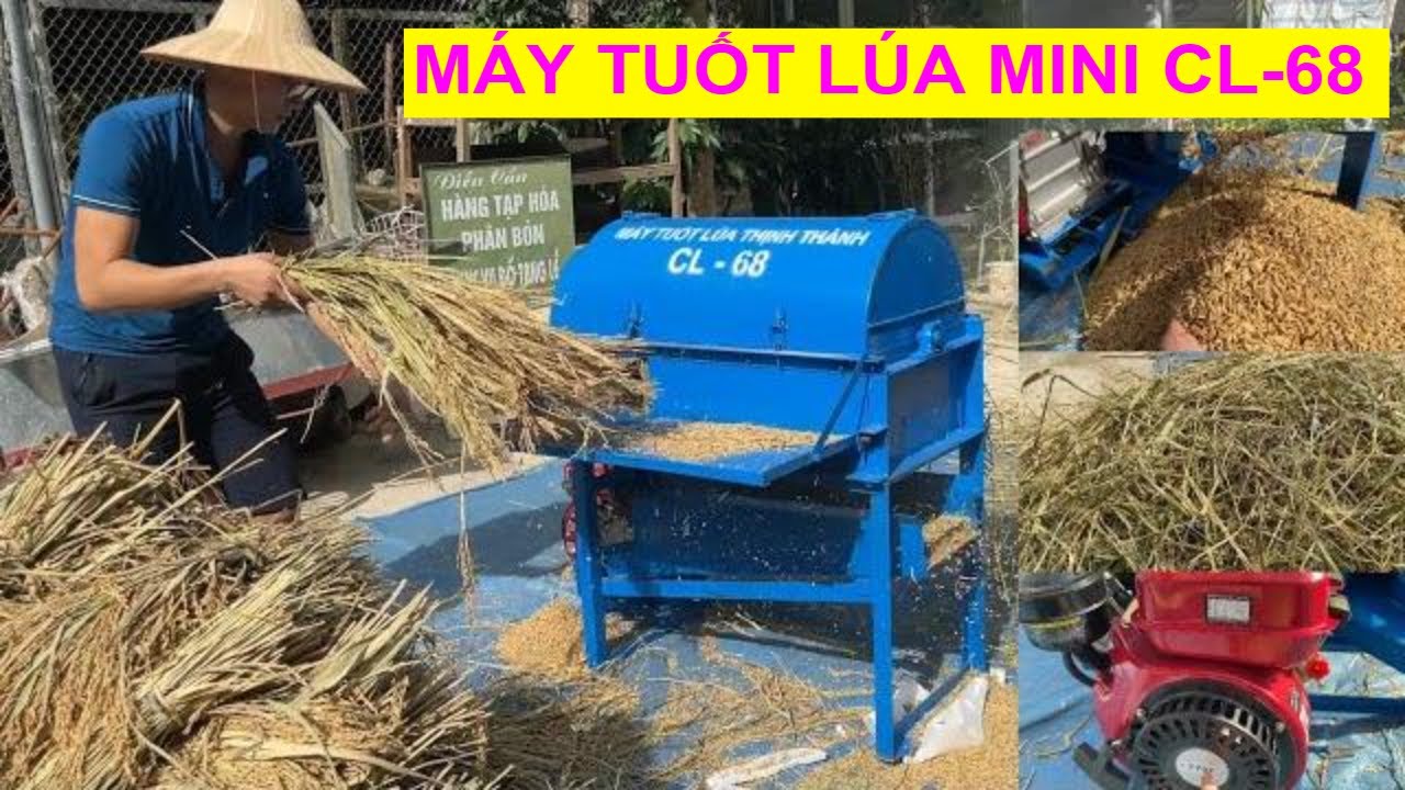

Does the material go around more then once in those? The ones I was looking at building are more like this, which is essentially a hammer mill, I don’t know what the grain loss is but I don’t imagine it is very high or else they would be shaking it.
The top of the line is the allis chalmers all crop which has settings for like 100 different grains. But it isn’t as retro cool as what you have. :slight_smile:
Here is a video I stumbled on, that is 100 years later technology. I find it interesting how the basic concept hasn’t really changed.

hi sean, only one pass-through on my tresher. the model based on the first treshers, when i remember right a invention of the american samuel turner…the engine works by beating by the teeth and striping out the grains between the teeth…
nice engine on the film.
important always the shelfs are really dry…
