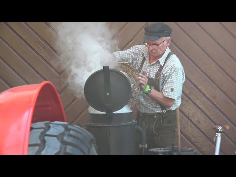

Mr. Tom, I think we are very kindred spirits (like most here), but every person is unique. Modern people are oriented in such a way that they run to the store to buy everything, old things are hardly repaired anymore, but for me the greatest satisfaction is if I manage to do something at home. This tractor was practically used up and suitable for scrap, I bought some new parts for approx. 500 Euros, but everything else is made from scrap material, now it has “priceless” value for me, it really is a universal machine.

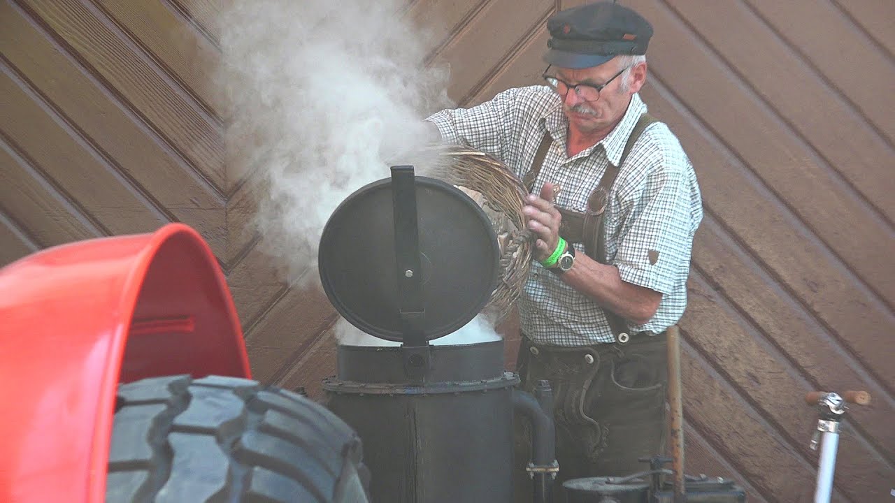

Mr. Bob, when you mention the picture showing how the smoke rises from the gasifier, let me say that this is how I “heat” the gasifier lately, I open the non-return valve below (put a twig under the flap) and open the lid, this is how a natural draft is created, the embers below it heats up, and a lot of steam is released at the top, then it only takes a minute or two to blow the fuel with a blower and get the gas to work.
I thought I was the only one that did that. I have to be careful because the tar will catch on fire and really get a fire going out the hopper top. It does help the upper part of the hopper clean the tar out of the gutters and drain to the condensation tar/water tank in colder weather conditions like now we are having.
