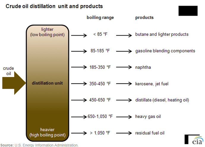

I watched a video of pirates making diesel from stolen crude in the back woods of Nigeria a while back. They were just boiling oil in a drum with an open fire and running the condensation pipe through a tank of cold water. I think they probably blow themselves up pretty often, but if they can do that in the jungle, surely we can do it with better equipment. It just got me to thinking.
As I understand it,
raise temp to 248F to boil off the water to atmosphere
Then gasoline at 104 F- 420F depending on specific molecular structure,
capture and re-condense
kerosene @ 500F
diesel 1 at 626F
diesel 2 a second time at 626F to remove more impurities
Then Lube Oil at 752F
Leaving tar/sludge/road pavement goo.
My questions are these.
- are these numbers correct?
- DO you boil off the water and gasoline together and capture them and then separate them in a second process?
It seems they would both boil out and re-condense together, or at least they would overlap.
I found this after I posted. so maybe it answers my questions.
Which prompts another question: How long would the oil have to stay at each temperature to accomplish each phase of “boil off”? Minutes? Hours?

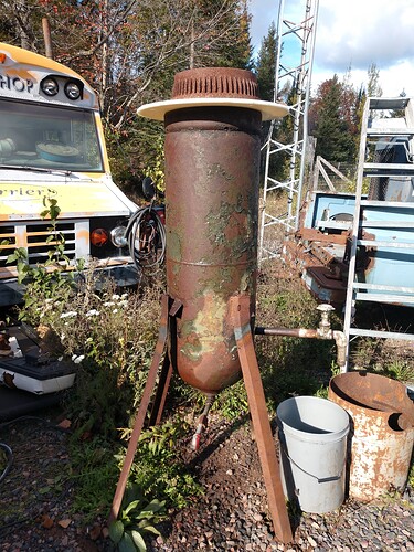

a. Research your particular engine/ fuel system. Find the water separator. Find the primary and secondary fuel filters. Run the numbers on all three. Find out what micron size the manufacturer called for each filter material was called for. Shoot for a fuel that screens 5 microns smaller then the vehicle secondary filter. This is not always possible with inexpensive filters. Racor makes a 1 micron filter setup and I plugged that up within a day with pump diesel. Look for army surplus filtration setups, or massive quantities of inexpensive WIX filters to build a oil house filtration setup.
b. Start gathering free oil. It’s not worth doing until one has at least 300 gallons. Ask yourself if you are committed to picking up oil. I have commitments for oil pick up that are 18 to 20 years old.
c. Embrace chemistry, build your plant in a building, not on the vehicle like gas producers. All the problems can be worked out discreetly within the shed.
- Physical Chemistry is the least expensive. Freezing, heating, spinning, settling, mixing, and the like, should be your first steps in the processing.
- Chemical reactions are more expensive, but can lead to less labor time, so may be cheaper if one has something to do that pays more. They are also essential to meet some of the goals, you set for your fuel.
d. Stay quiet about it.
I agree with Bruce. I used a settling tank, and homemade bag filters, Then commercial filters. When I thought I was getting pretty clean then I ran in a centrifuge. In my case, I always thought it can never be filtered enough. If you know a bit about where you are collecting the oil from makes a difference. Some places pour antifreeze in with the oil, transmission fluid and in the first settling tank or bag filters you will find metal shavings, bits of hose and gaskets, even possible floor sweepings.
Seventy microns is the thickness of a human hair for reference.
You might find a centrifuge on ebay like I did. Here’s the link to a centrifuge like I used. US Filtermaxx 10,000G WVO Biodiesel Centrifuge Oil FIltration WMO Black Diesel | eBay. I picked up the one I have for around $400 used.
