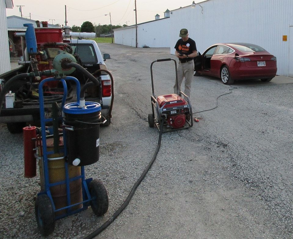

This here is Gary Gilmore Charging a Tesla with a charcoal gasifier. 2.5 kW will not get a Tesla very far with a short amount of charge time. So well within the time range of capturing all this on a show.

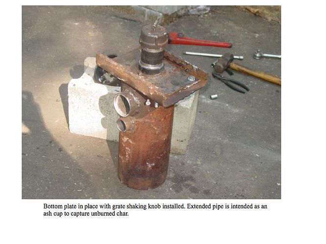

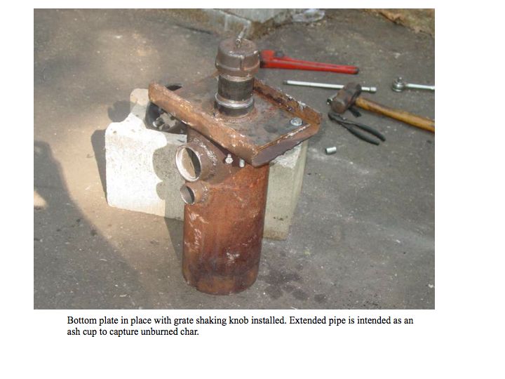

This was tried by Jim Mason many years ago-- to build a woodgas truck in an aloted amount of time; I think it was a long weekend. They picked the simplest design to build which turned out to be a tar maker. The group was from across the US and most had to go home before it was completed.
I know of one simple design that could be built in such a short time. However, the builder made it work on an American car, but he admitted it was too simplified,
JOE MONTY’S SIMPLE BUILD;

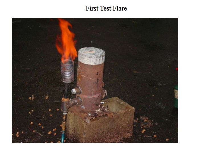

FLARING;

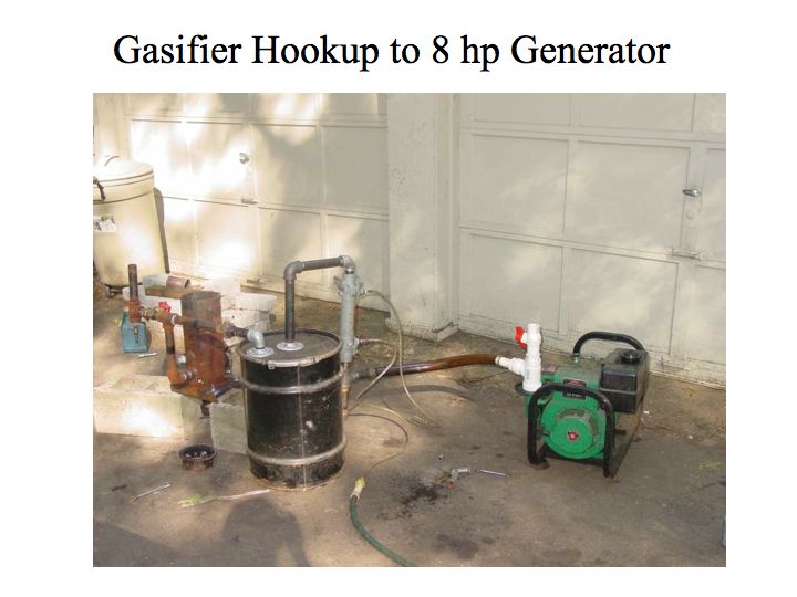

RUNNING AN 8 hp B&S ENGINE

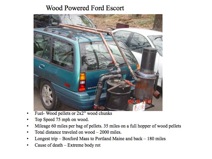

GASIFIER ON CAR;
( This picture has his modified gasifier— the original mounted the same)
