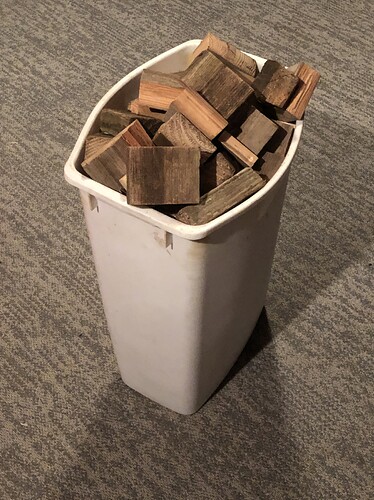

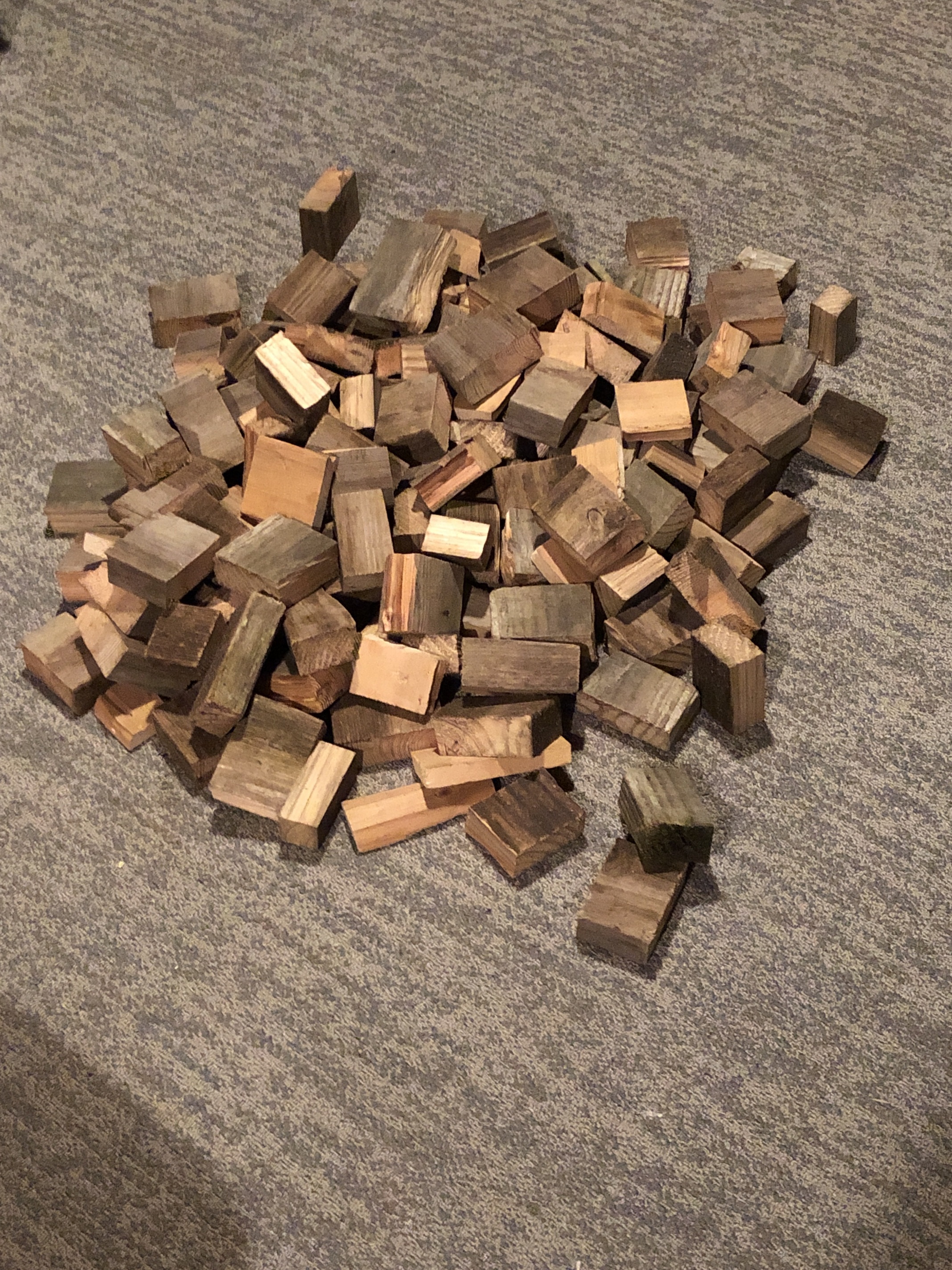

This afternoon I wanted to see what I could do with an old small circular saw and some junk lumber so I could get an idea for chunking some wood for Jakob on his trip next year. So I got to sawing, and I had two pieces of old lumber each 2x8 inch and probably 6 feet long. After chunking into pieces probably 3x2x2 inches, I filled up a garbage can and weighed it. It came out to just under 35 pounds without the garbage can. In about 10-15 minutes I finished.
Perfect! Now use your hatchet to chop these into finger sized pieces. (Do not hold the wood with your fingers while you chop, else you get bloody finger tips.) Put them in a TLUD stove, boil a pot of potatoes, make a dozen hard-boiled eggs, and some hot water. When the flames go out, you will have only glowing charcoal in the stove, which is dumped out into a container with an air-tight lid. Lacking that, dump it into a pail of water, and then dry the charcoal out later by laying it on a sidewalk or hunk of tin in the hot sun. Save this charcoal. All Gasifiers need charcoal. They either make it on the fly, or in the case of the Simple-Fire, just use it as is.

Thanks Tyler I processed wood that way for a long time It works. I will keep you in mind as planning progresses and let you know if we can make it that way.
Thanks Jakob, it’s good for when I make a gasifier eventually as well.
