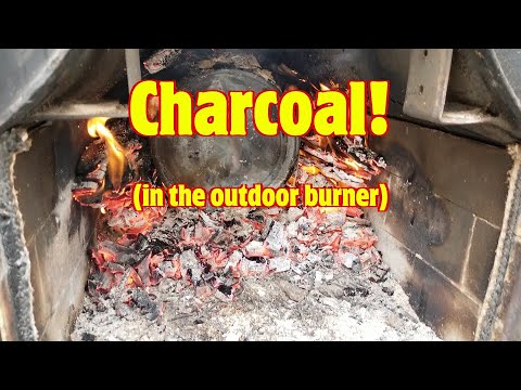

I’ve made a lot of retort charcoal in my outdoor boiler:
