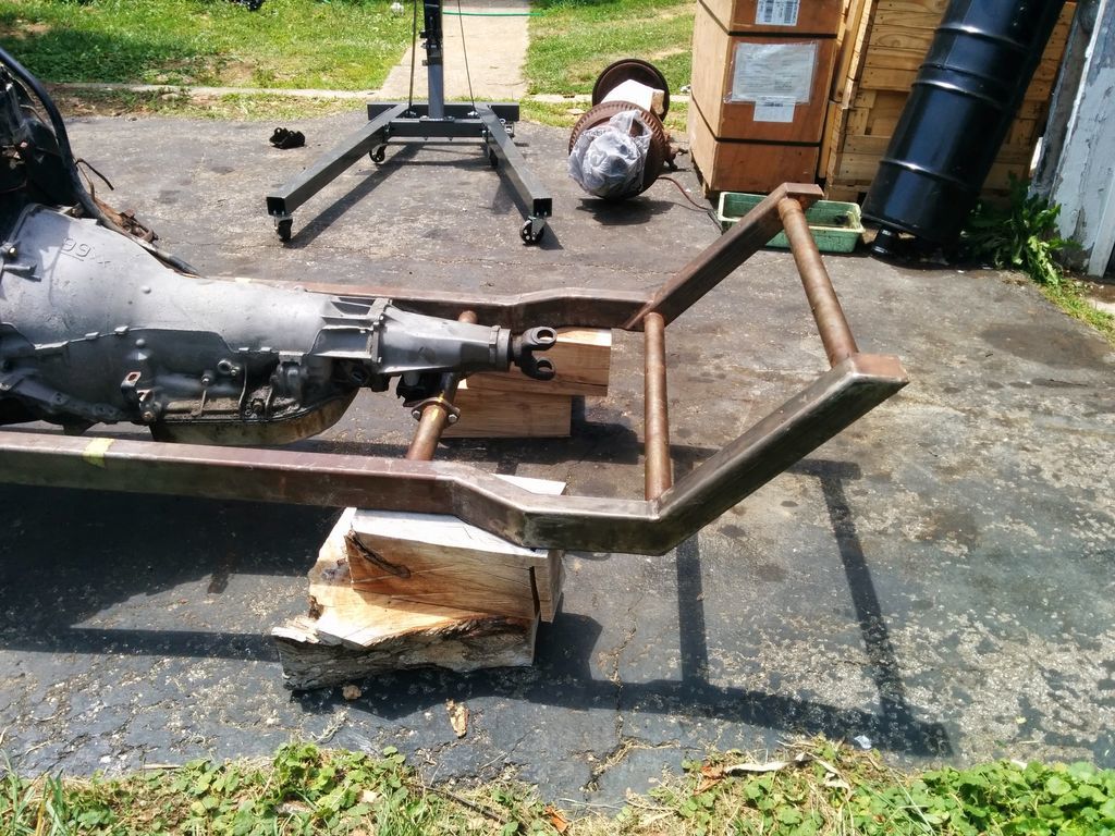

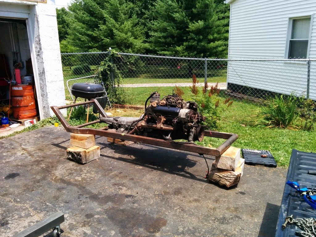

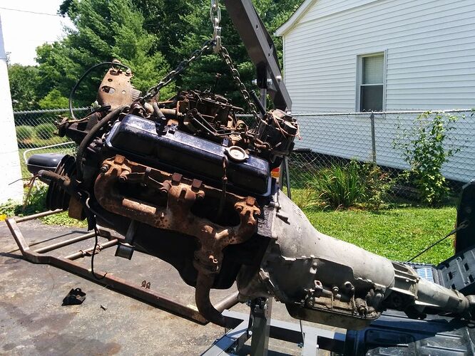

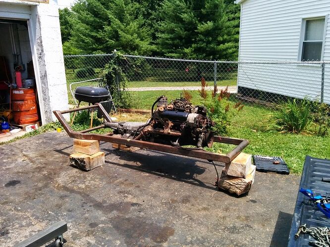

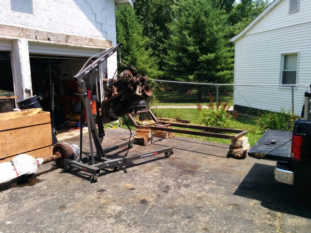

New transmission mated and bolted into the chassis.
Looking good Chris, when you get it running I wood like to see a video of Mad Max chunkin wood,
I “wood” like that too… :slight_smile:
I thought you “would” like that .lol
Where did you get that frame that it is mounted on? That almost looks like Peter’s fabrication skills.
Bingo! See earlier in this thread, he sent me home with a chassis and a rear axle (among other things). Excellent fabrication work! I hope to be there someday…

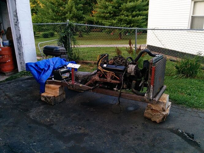

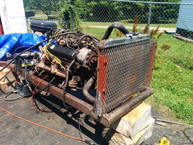

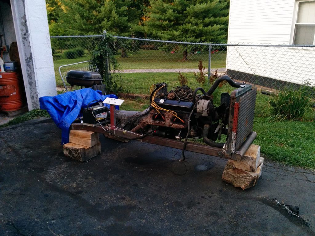

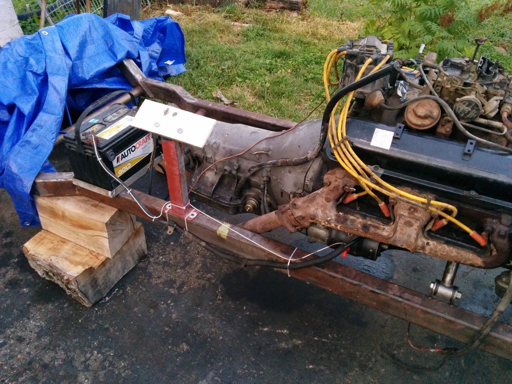

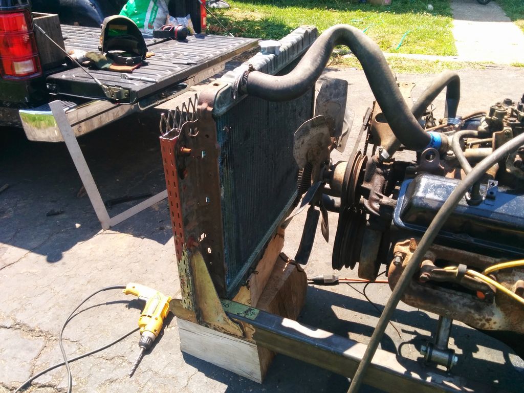

Bit of progress - got a radiator mounted up, the one from my old Dodge (replaced it before selling the truck, saved the old one). Made a front grill from expanded metal.

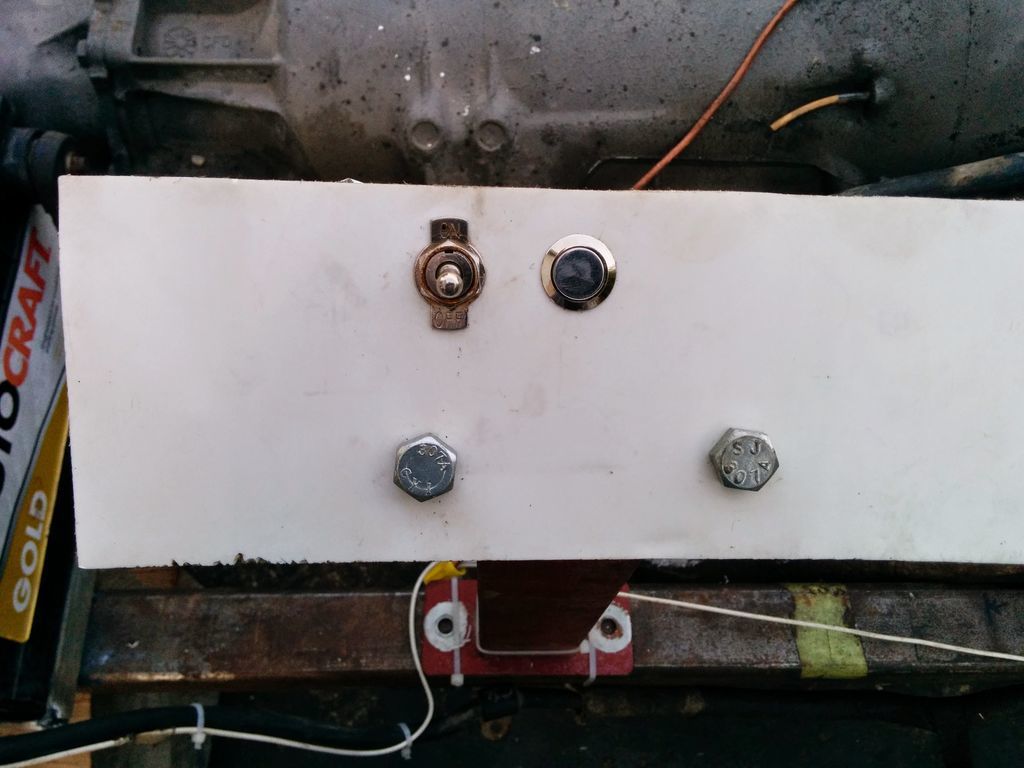

Also added a battery tray and ignition control panel - I can now crank and run the engine by hand-dribbling gas in the carb.
I like it… almost looks like the start of a Hot Rod… :slight_smile:

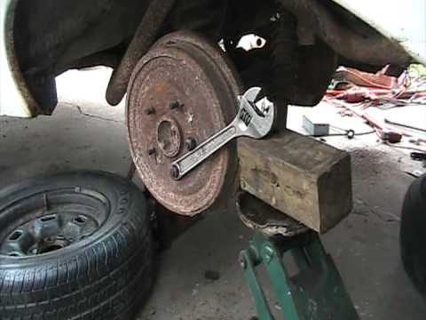

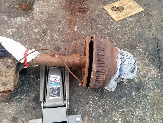

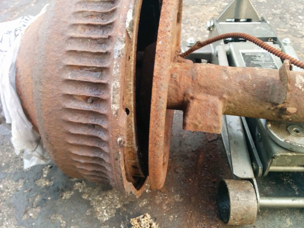

Trying to get the brake drums off the axle… man what a pain! I’ve beat on this side till I’m about wore out, and only got it this far. Can’t’ see what the hold up is, just the shoes grabbing it I guess. Just a few more licks and I’ll have it off (I hope!)
Good Morning ChrisKY
Looking good alright.
For now if you want you could high pole mount a bottle of gasoline and gravity feed that “RottenChester” carburetor. Slick way is a plastic boat gasoline tank electric pumped.
I figure you have the out and in transmission cooler lines for now just rubber hose looped? You do want to only run with fluid in the tranny and pumping to keep it internally lubricated.
Since your trans will be so lightly loaded at a wecking yard you could just snag off a powersteering line cooler loop and hang that front or rear of the radiator for the trans cooler.
Get some kind of radiator fan shroud while you are at it.
You could easily loose 80% of that big flex fan capability too. Or at least use all of that engine blown warmed air to do some relevant like just in time wood fuel dring.
Like say expanded metal boxes, lift off hooks hanged on sides and over the top for fuel chunk drying and /conditioning. 6-8" thick across and X by X long and high. Enough in each for a one hopper load recharge. Theses be your neighbors sounds dampners too.
Stationary it can be fun to thermal integrate all of those normal vehicles blown away heats now just an arms reach away waiting to be used rationally.
“Let NO BTU Escape Free, Unused!!” s.u.
