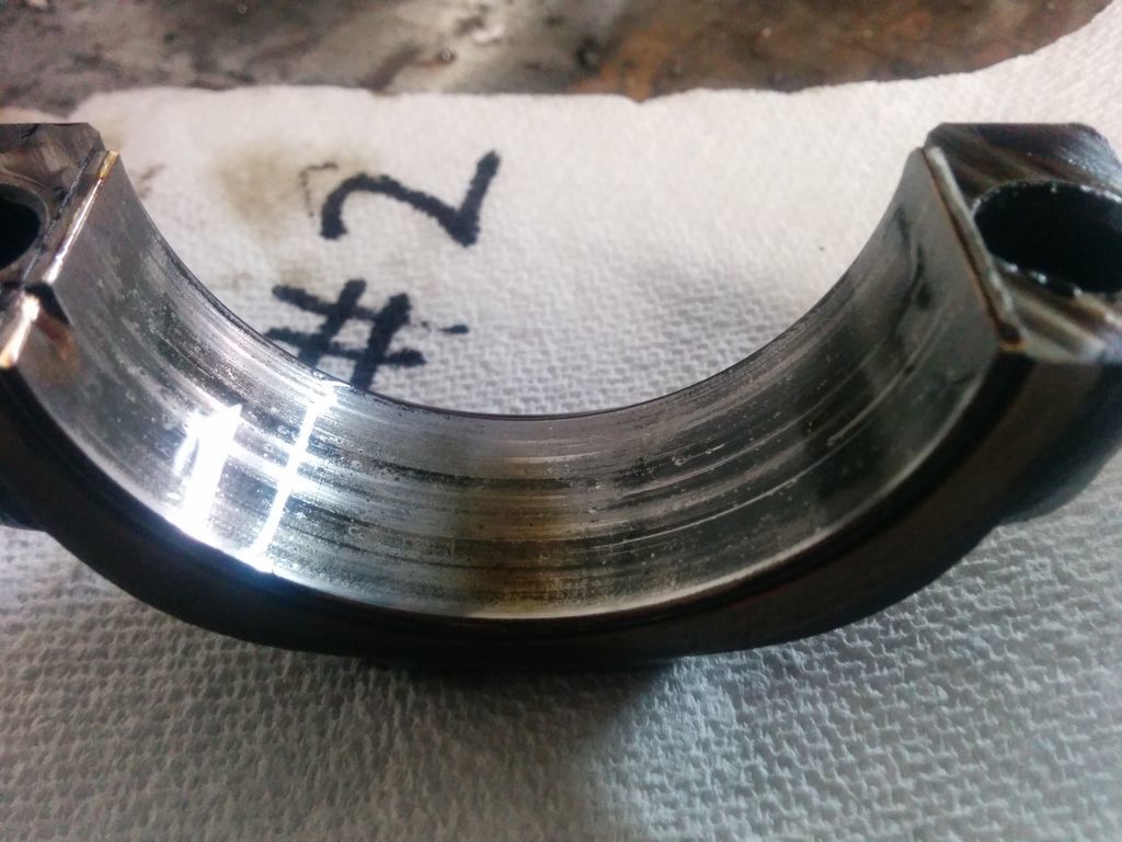

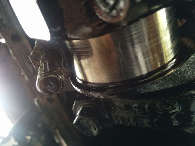

Replacing the bearings because of a loud knock in the bottom end. Crank looks OK. In fact the bearings aren’t too bad - the knock may be elsewhere. Sure sounds like it’s in the pan. Still, for a few bucks I’ll put bearings in it.
Knocking sounds video: https://www.youtube.com/watch?v=Hr7X1fdNVng
Audio only: https://dl.dropboxusercontent.com/u/20515616/v8-chunker-noises.mp3
Bearing photos: Album 1 and Album 2

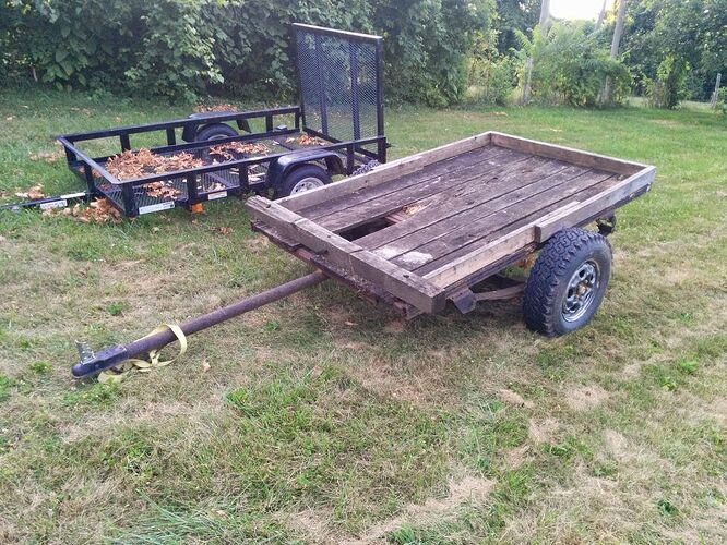

Brought home a junk trailer for parts. Trailer pulled decently coming home. Fellow I got it from was real nice, and interested in the truck.

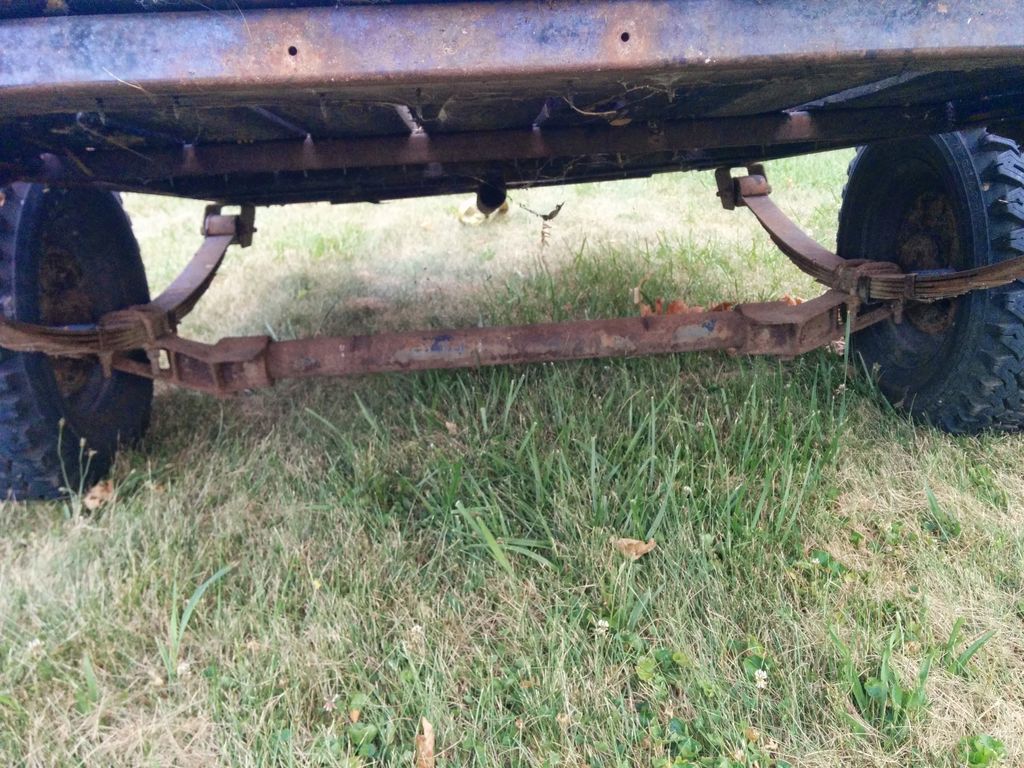

I need to move this thing occasionally, so I’ll use this axle and tongue for moving around the yard. Any clues what this axle came out of?

Hi Wayne, good point on the fan etc. I will plastigage the new bearings before assembly.

Chris, I can’t see the ends of the axles in the pics but are they the kind that at one time turned for front steering axles? It looks like the leaf springs were moved out near the wheels from the flat mounts near the round center section so the wheels could turn without hitting the leaf springs.

The axle for sure is out of thr rear of a Chtysler/Dodge/Plymouth front wheel drive mini-van.
You audio file more prevalent ending noise is once per engine rotational. A rod big or little end with be louder on every other rotation.
I think you have something hard rubbing inside the bell housing like a flexplate/torque converter bolt.
