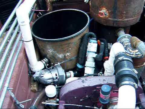

here is the lattest video if my âVolkswoodâ retrofit. my sys was in storage for a little wile as gas was affordable. now that it has gone over 4$ again, we will be using it again. the retrofit is taking a wile b/c i am addressing some of the issues i didnt like b4. like now there are no bottle necks its all 2". now instead of the gas starting on one side and going around the bed rails and coming out the other side, it now goes up both sides and exits up front. the cooler was too small and instead of just spending money and making another one, i decided to test weather it makes a difference adding more flow. if it works i will make a new one. i live in the mountains @ aprox 5757â so power is diminished as opposed to driving @ sea level. the fastest i have ever got it to climb the mountain is about 35 MPH on the flats it goes as fast as you want. im hopping the improvements will help it go a little faster but it dosent really mater the speed limit is 35 i discovered wood gas in 2008 and i didnt have the internet at the time it took me 5 years of tril and errors with the open top units until i made my first imbert and it all finally worked (no tar) then we built this car i specifically chose a VW b/c you can take the pistons and cyls off the engine and replace them at a relatively low price if some thing should happen it started as a beelte and i did the custom body the top is removable in two years i put over 300 miles on it with the gasifier it isnt much but were i live nothing is far apart and i dont believe in driving it unless i need it =)

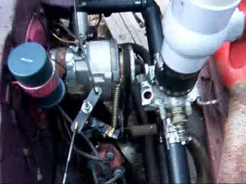

this is exsiting i got the wood gas intake manifold done i used a subaru throttle body now it kinda reminds me of the Total Recal chick b/c it has 3 intakes lol =)
these are my new wood gas intakes from experience i have found it works better if you pipe in under the carb (if carbureted) and run a separate throttle body ill be using the TB off a subaru i got it for free and that makes it the right part =)

right so we are done with the gasifier. now i just have to pack the bed filter, build the cabin controls, and those block offs for the exhaust. then i have to make some wood, i have some oak and some western red cedar and some hickory lump charcoal to pack the bottom of the reactor for the initial start up. maybe next week. =)
Hi Xoie, looks great. But I see that the intake air supply and control valve is in side your cab. When your the engine is not running the Imbert gasifier will build pressure and the wood gas smoke will come out. That is (poison) carbon monoxide gas. I would reroute the intake and have it go back out to the out side of the cab to be safe. The rest looks good on the location of the control valve. Also break up the charcoal into smaller pieces no bigger than a one inch in size, smaller pieces are better to make a char bed so you will make good gas at start up.

when not in operation the control valve is closed so no gasses can come back and this car has no side windows i think its sufficiently ventilated and yes that coal will have to be broke up i have the control valve there b/c it offers precise tuning with no linkages to get slop =)
most of the time it dosent even have the top on it so i think its well ventalated becided i allready put 300 miles on it in this configuration with no problems =) but i get were your going and i would never leave the valve open when not in operation =)
