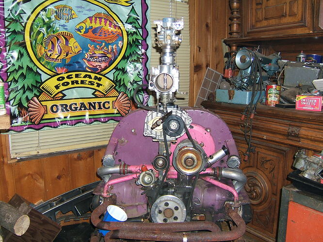

Your nobody in the car world untill you intake looks like a mile high monument of some sort lol my liberization from the naturaly asperated energy cast is almost completeit has a car and a throtle body b/c the carb is so it can run gasoline and the throtle body is for running it on wood..i think it looks awsome lol =)
It does look awsome. What kind of blower are u using?
its an AMR 500 =) they are used on minis and subarus =)
Thats so tall you might need guy wires to keep it from blowing over in a storm.
Actually a micro roots! Cool. I worked on devo of turbo for 1.9 TDI.
How much boost? Do you get back all your power compared to dino?
Another option is the VW turbo off the 1.9 PD engine.
The waste " picket style " gate system on the older ones lets it spool up faster than a normal wastegate turbo.
You do not want a lot of boost here.
Especially on gasoline without internal modifications, but the high octane of producer gas and slow flame travel mean it will run with 3 to 5 PSI and you can recover all your lost power without the parasitic loads a super charger brings.
Cheap too.

its suposed to do aprox 5lbs of boost @ 2:1 overdrive =)
ya the super is self regulating it will only produce aprox 5lbs no regulation required i used this sys as opposed to the turbo dew to the lack of complexity
Hmmm. 5psi is about 1/3 atmosphere, so should increase air/fuel charge density by about 1/3. Sooooo, .7 x 1.33 = .93. Whould you feel that your engine is making 93% of the power it did on petro?
i have no idea yet as i have not run the engine in this configuration yet
How are you going to brace it?
Will not take much vibration to cause trouble.
this is how im going to send it it has a brace going down to the old fuel pump boss =)
