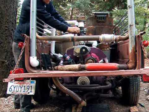

I think there is a real risk your studs will get pulled out of the block.
you do know they are threaded in right and the bottom of the intake manifold is bolted to the case at the T in the manifold i think it will be fine =)
i dont think its going to vibrate around the way you think this one looks fine and it basicaly has the same brakets
here is another one same basic setup
If other people do that way should be fine then
Watch it just the same, yours is longer more weight and there remains a chance for a sympathetic resonance to shake things.
i completly understand ill keep an eye on it =)

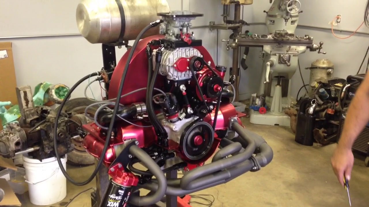

finally got the supercharger on and tuned pretty good the wood gas interface is not on it yet i just wanted to get it running first then ill ad the wood gas IDK how much boost its making yet i suspect 3-5 according to the pulley math =)
I love the sound! Cant wait to see how it likes woodgas.
