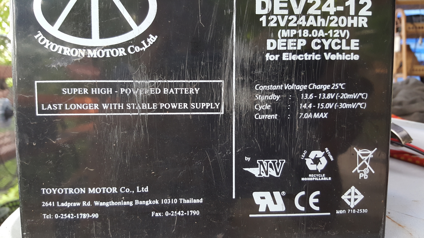

Deep cycle battery’s , if used for standby, require lower “floating/charging” voltages then battery’s running on cycle duty ( load / unload ) see picture.
Same goes for solar systems…
