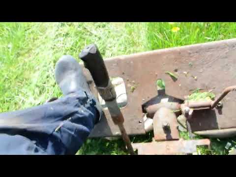

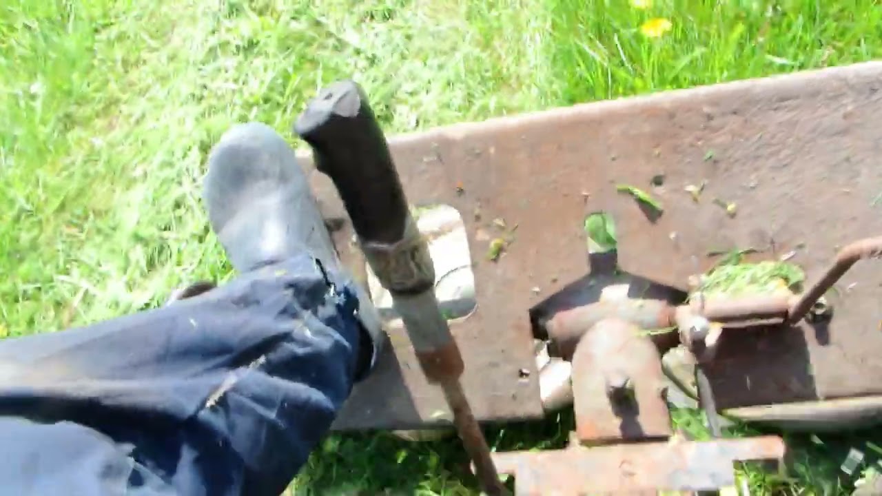

“great success” as Borat used to say. ))
only thing necessary is a counterweight on mower,
i have to lean forward in order to keep mover pressed to the ground
and it is uncomfortable
