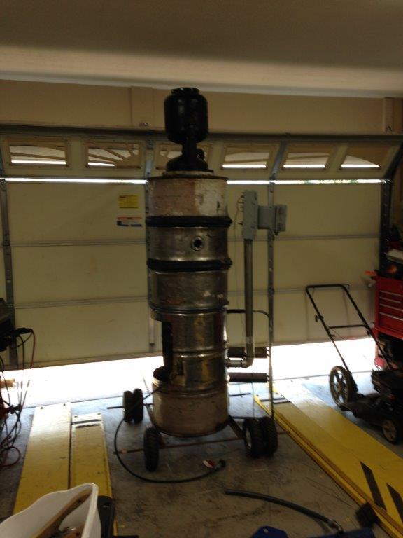

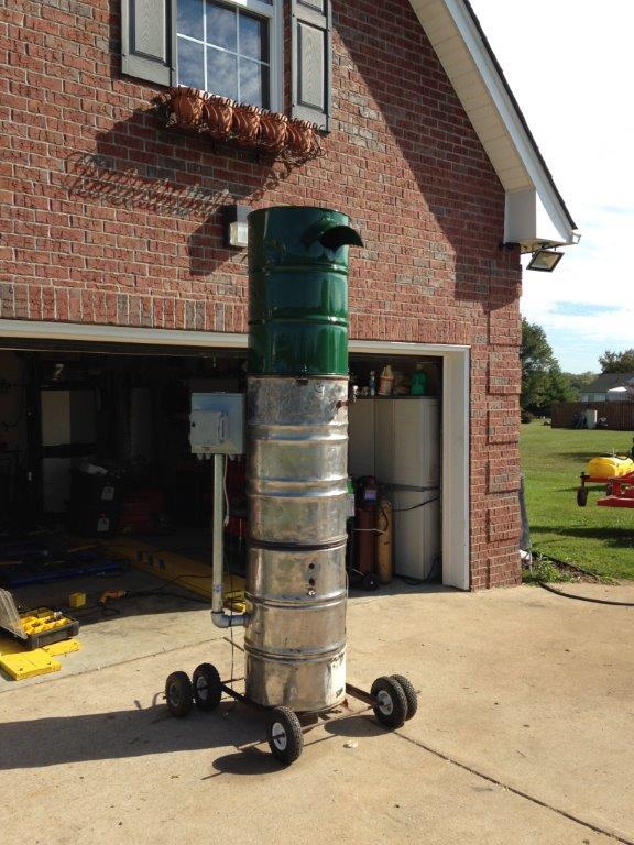

This is a little off topic.I built a 304 stainless waste oil boiler which produces about 160,000 btu. Eventually I’m going to try to fire it with wood gas.
It has a small computer in it to run the ignition.
Stainless drums came from George Dickel Whiskey in Chris’s neck of the woods.
I guess I’m known as the Astronaut Farmer in my neighborhood lol

It needs more tires! 4X8 wheel trolleys would look like 747 landing gear. It’s working for me!
Stephen
Filled with antifreeze it will flatten the tires if I only use 4 lol In fact, it is so heavy that when I moved it, the angle iron base sagged. Oh yeah, I need to fix that before winter : ) Another project I need to get done.
How does the saying go : if your hobby needs scaffolding to access it you are in trouble!
